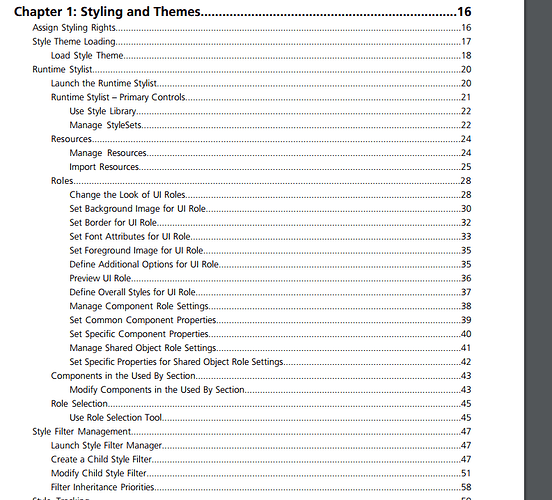

Epicor Customization Guide → Styling and Themes
https://epicweb.epicor.com/doc/Docs/EpicorCustomization_UserGuide_101400.pdf

I am on version 10.1.400.20 and I tried following the user guide, but I don’t see all the menus it is showing. For example, I went to Settings, General Options, but I don’t see Form Styles as an option and I don’t see any mention of runtime Stylist. What am I doing wrong? Thanks
your user settings are probably not setup to maintain themes.
Do you know where I would go to check? I tried looking in security and I clicked the box next to maintain themes but I am still not seeing the Form Styles.
