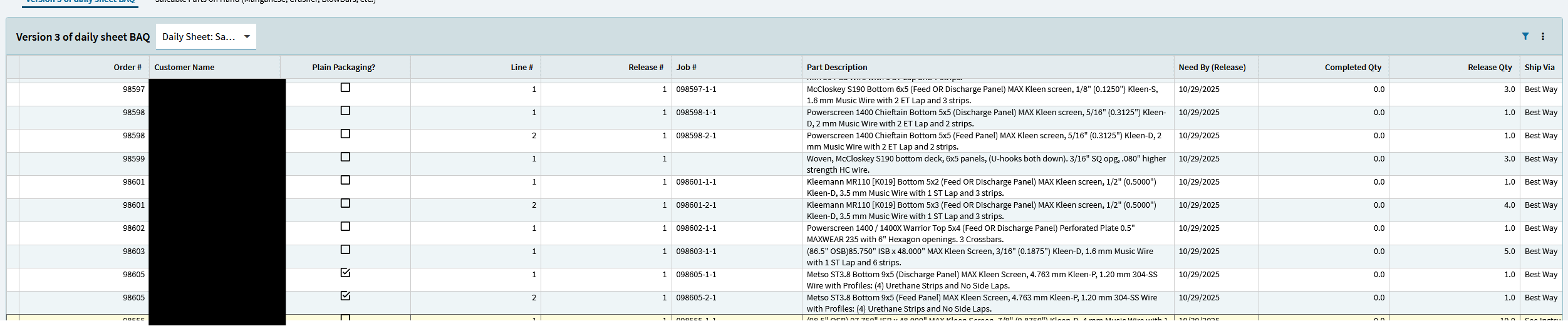

I want rows to get taller to fit a long text column automatically. I’ve seen two threads that make me feel like this might be possible, but I can’t figure out how to do it.

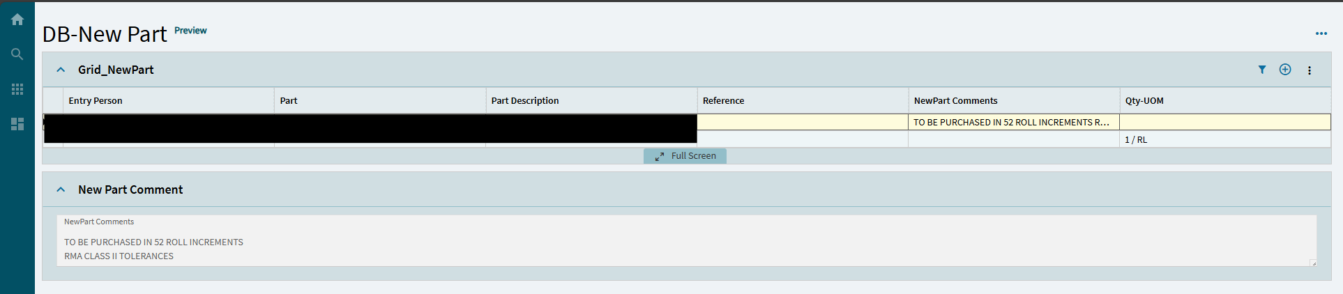

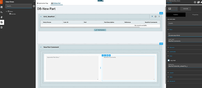

I would love it if someone chimes in and figures it out. We have a few DBs with multi line that we would like to display properly in-line. The workaround we have implemented is to drop a separate Text Area Box somewhere else that is visible and binding it to the field of the selected row. This displays the text in multi line, just in another section. Not the prettiest but it works for how we need it.

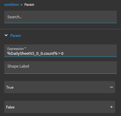

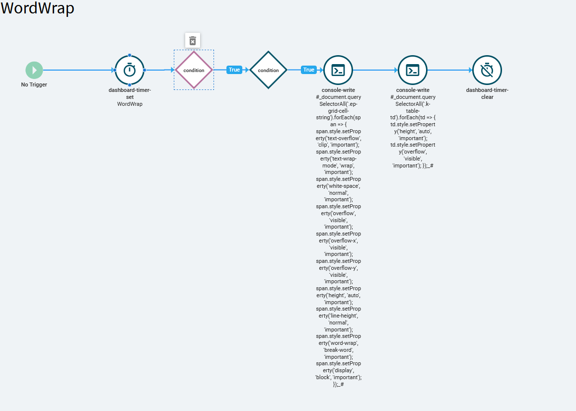

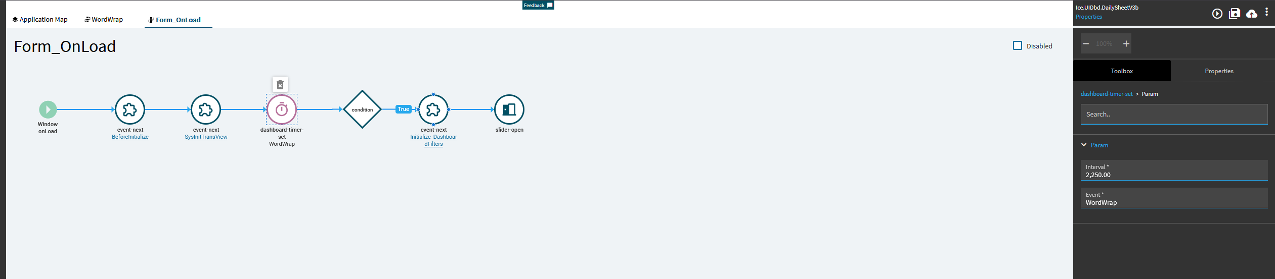

Ok.. think I found a really bad solution, but my users will be happy until it randomly breaks because its totally off the reservation and not recommended…

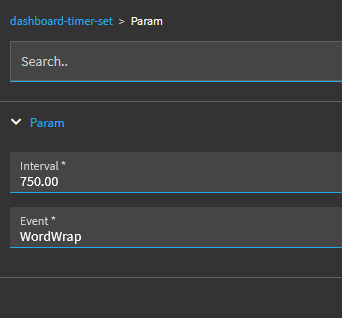

onForm load, use dashboard timer to run WordWrap after a short wait:
WordWrap looks like this:
The console write lines contain:
#_document.querySelectorAll('.ep-grid-cell-string').forEach(span => {     span.style.setProperty('text-overflow', 'clip', 'important');     span.style.setProperty('text-wrap-mode', 'wrap', 'important');     span.style.setProperty('white-space', 'normal', 'important');     span.style.setProperty('overflow', 'visible', 'important');     span.style.setProperty('overflow-x', 'visible', 'important');     span.style.setProperty('overflow-y', 'visible', 'important');     span.style.setProperty('height', 'auto', 'important');     span.style.setProperty('line-height', 'normal', 'important');     span.style.setProperty('word-wrap', 'break-word', 'important');     span.style.setProperty('display', 'block', 'important'); });_#
and
#_document.querySelectorAll('.k-table-td').forEach(td => {     td.style.setProperty('height', 'auto', 'important');     td.style.setProperty('overflow', 'visible', 'important'); });_#
The text wraps great. But any changes to the html, css, or sandboxing could kill this solution at any time.

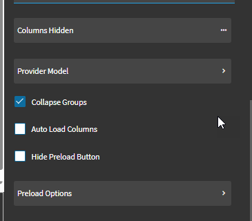

There is a setting in App Studio that could be new with 2025.2.10 as I’ve never seen it before :man_shrugging: at the bottom of the Grid Model. This fixed the auto-expand groups issue… not so much the rest of the fun but small victories I guess.
