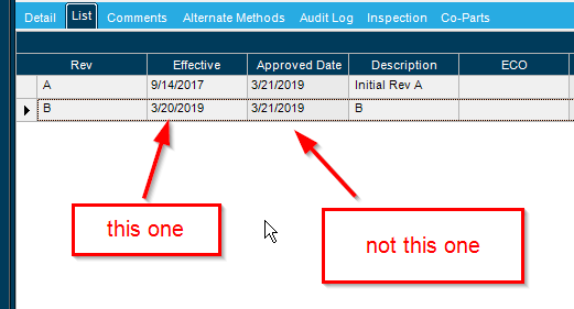

alright, so the order will pull in the revision with the effective that that is the nearest in the past.
Rev A effective 1-1-2017 approved
Rev B Effective 1-1-2018 approved
the order will pull in Rev B, with the option to change to Rev A
If you have new revs, but you want to use the old one, you need to make the revision that you want to be used the one with the newest (but still in the past) effective date.

That doesn’t change the effective date. And doesn’t make it pull in automatically on the order.
But if it pulls int he nearest from the past, then by having the revision checked in and out every night would allow that one to always be the nearest one, correct?
Effective date, not approved date.
And you can approve/unnaprove without checking out/checking in. But that doesn’t fix what you want anyways.
