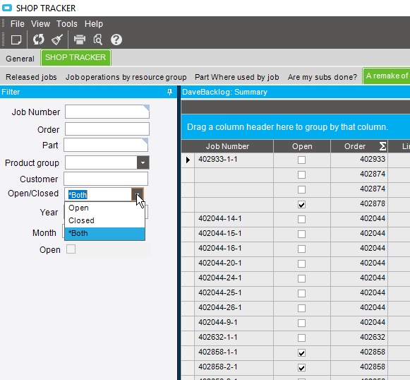

I usually set up a calculated field that has “openboth” “closedboth” for the values. And then in my dashboard I have the options typed into the drop down “open”,“closed” and “*both” for a startwith filter. The * works as a wildcard. I don’t show those columns (I show the check boxes) but you can still filter by them. You should be able to use the same technique for released and planned.

Both a BAQ and a Dashboard. Thanks I’ll give that a try. But I don’t understand what you mean by a calculated field for “openboth” “closedboth”.
if you do a starts with filter, and filter by *both, since the word “both” is in both of the fields, it will show all of them. It ends up being a contains filter. You can use whatever word you want, but it makes more sense to the end user to pick in the drop down *both.
I do the same as Brandon, but just set the value to “YB” or “NB”
Usually just make the Calculated field name the original, with _YNB on the end.
To allow filtering parts by active, or Inactive or either, the Calc filed is named Inactive_YNB
The formula is if(Part.Inactive = 1) then 'YB' else 'NB'
Then on the dashboard I hide the Inactive_YNB column on the grid, but have it as a prompt input. I use the “MATCHES” instead of “starts with”. Then the user can enter a Y, N, or B.
And they user doesn’t even need to really enter the ‘B’ for both, as a blank input is ignored.
For my use case, I didn’t want a blank input, as the loading of the dashboard is painfully long wide open, so I default the drop down to “open”. However that is based on your use case.

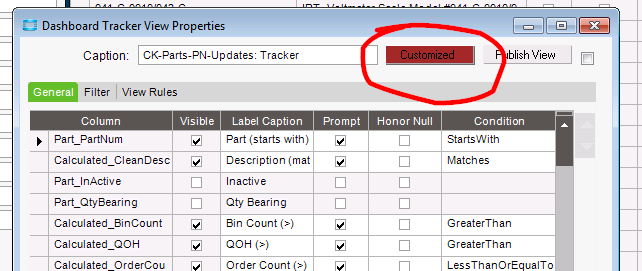

I decided to test doing what you did, and accidentally customized a dashboard we use. Is there a way to “de-customize” it?
I’ve deleted all the controls I added, and returned the properties of the built-in controls to what they were.
But the Tracker still shows it’s customized. And I can’t deselect any of the “built-in” controls.
Not as far as I know. I use a lot of screen shots for re-doing :poop: in dashboards. It’s pretty annoying. I’m assuming you tried closing the dashboard without saving?
And if you don’t need to make changes it isn’t a big deal, and if you do, you can make them in the customization. It’s just not as easy as in the stock screen.
