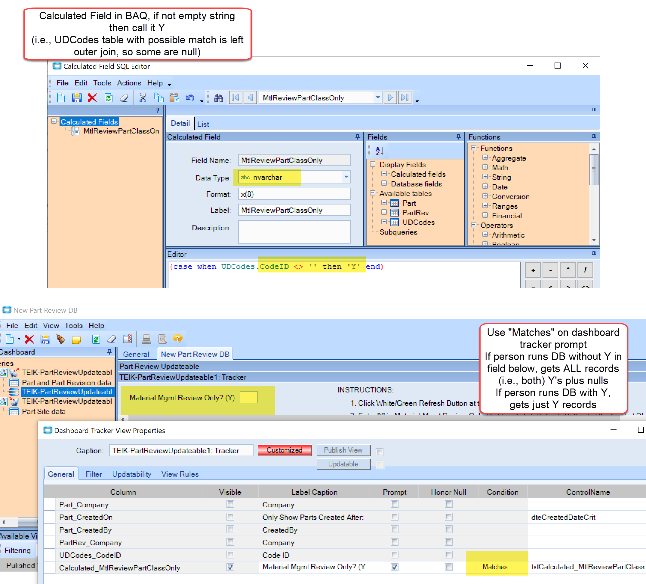

Hi Calvin,
You’re method with BAQ calculated field and instead of “starts with” but I used “matches” on the dashboard tracker prompt works well. I decided to use the UserCodes table instead of nasty hard coding part classes for review in calculation. Here’s screenshot of my solution in case it helps anyone else.
Nancy
As a follow up … one of the upgrades (10.1.400 to 10.2.300 I think) actually broke my original functionality.
I think I used to use MATCHES so users could enter a B (for both). In 10.1.400 that would work. But in 10.2.300, I’d have to type YB for yes, NB for no, and *B (or maybe it was %B) for both.
