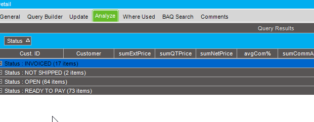

Thanks that covers the SubQuery settings. The group by I’m talking about is the results the Display Fields already have the proper checks for the aggregate calculations to work.
They took that away. Now you can only filter on the results grid not group by.
Thanks!
Sounds like a Frideas to improve Kinetic BAQ Designer is in order.
Group by is fixed in the next release
