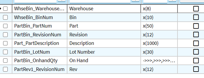

I’m well versed in the classic BAQ Report Designer, but am clearly missing something basic with the Kinetic interface because I can’t seem to add a filter/sort. I can click the “new” (+) button and that creates a blank row, but I have no options to select from the drop down and can’t type anything into the fields. Any ideas?

Thanks for the tips, George! Turns out if I run it with the classic interface (vs. Kinetic) all the options are present, and I can filter my BAQ Report.
