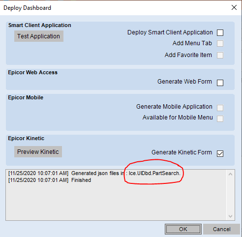

I checked the Generate Kinetic Form to Deploy the Dashboard.

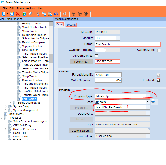

Then I added a menu item, selected Program Type: Kinetic App, and found the program from the Deploy Dashboard step.

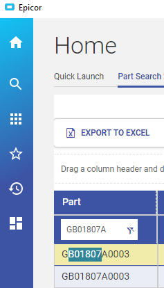

The BAQ Grid opens with the column filters on and you can highlight a portion (and Ctrl C to copy) text out of the displayed boxes.
The BAQ Grid also returns results faster.

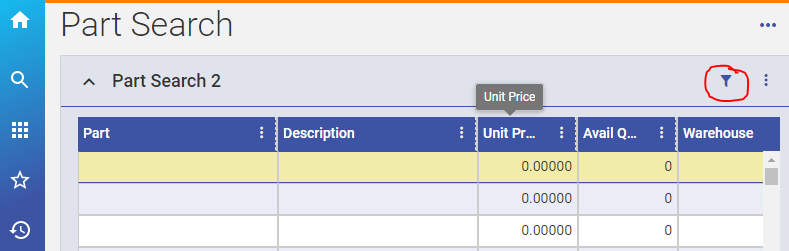

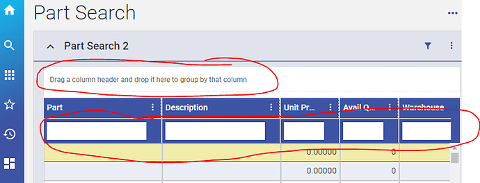

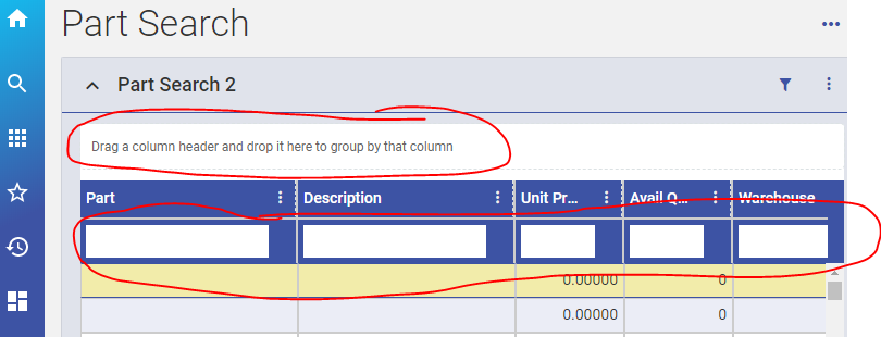

Does someone know how to get the Kinetic Dashboard to open with the Search and Group Boxes available upon opening?
This is what I get now:
This is what I want upon opening (after clicking the funnel icon):

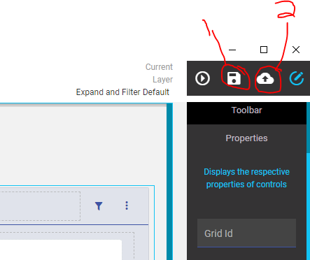

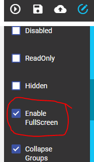

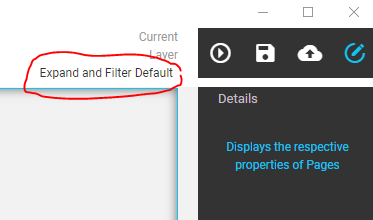

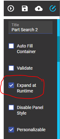

Here is how to set a Kinetic Dashboard to Expand on opening and show Filter and Grouping.

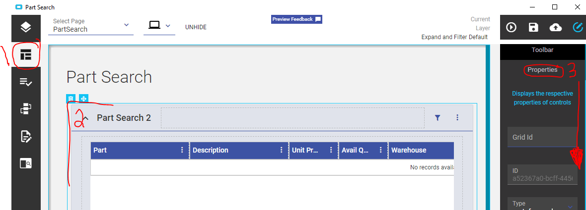

Open the Kinetic Dashboard and Click on the three dots to the right (and select Customization).
Select the Layer you want to modify or create a new Layer.
Click the Layout button, then click on the dashboard, then click on the Properties:
Then Scroll down on the Toolbar properties:

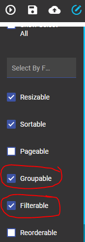

Keep Scrolling down:
Keep scrolling down:
Then Save your customization and Publish it.

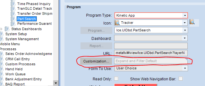

Then in menu maintenance, make sure you add the customization layer you just made.
It seemed to take some time for the Customization to start working, even after restarting Epicor.
