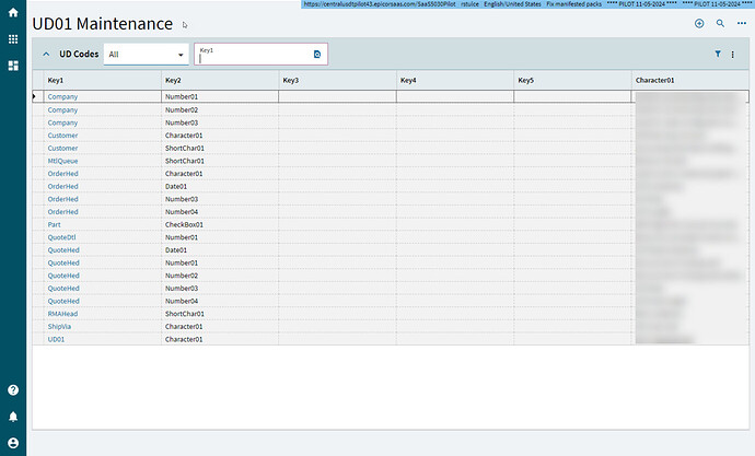

Why can’t you use the Kinetic version of UD forms?
Others will correct me if I’m wrong here, but I think this is still possible and it’s just another App in Application Studio. Am I right Studio Artists?
Same question. I’ve used them without issue.
You don’t HAVE to use the UD screens anymore if you don’t actually need to enter data in a UD table. you can just make a whole new app.
