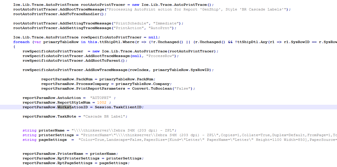

To get the WorkstationID in a DD use
Session.TaskClientID you can just inspect an Auto-Print Source Code on your Server, no different than what Epicor does:
reportParamRow.WorkstationID = Session.TaskClientID;
EDIT:
I see you were after the Computer Name… We’ll for your 2nd part add an AutoPrint and then inspect the code that Epicor Generates for more Printer related samples :slight_smile:
\\SERVERNAME\EpicorInetPubLocation\Server\BPM\Sources\DT

Thanks for the code sample, as well. This appears to be precisely what I’m envisioning. I’ll see what I can do with the direction you have provided here and will respond back to the thread when I have some progress (might take a few weeks because I start vacation tomorrow).
@Chris_Conn - I did follow your “callContextBpmData” example to store the DYMO printer name I isolated; and from that, I was able to pull it back to the BPM. So, thanks very much for presenting that option.
I think I have isolated the autoprint code that I’ll need to pull this off, but when I save the custom code block, I receive an error concerning assembly references:
