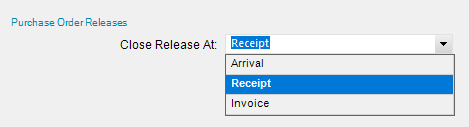

There is also a setting in the Company Configuration (Modules->Materials->Purchase) that controls when a PO gets closed:

This company has it set at Arrival. I can see receipts, first through inspection (Pur-Ins, and Ins-Stk) on 7/24, then a couple Stk-Stk on 7/27, with a issue to work order (Stk-Mtl) on 7/28.
