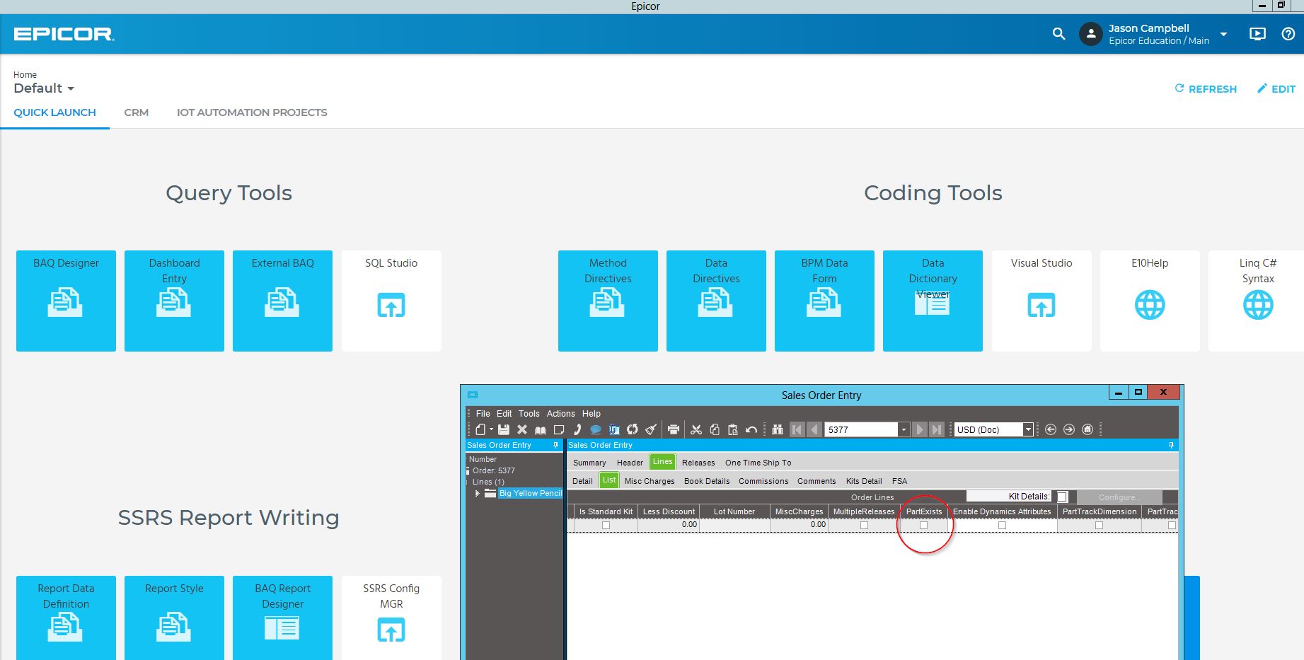

IF you decide to go with converting those POF lines into real part numbers, you want to review a hidden flag on the OrderDetail table. You can see it in OrderEntry~Lines~List view. That field is called “PartExists”. It’s an indicator at the Sales Order if a Part has a Part table record.
Initially that flag is unchecked when a POF is added to a sales order line. After you create the Part record in Part Entry and refresh the sales order, this box should now be flagged/checked as TRUE. Once you have that confirmation you can ship the Non-Qty bearing line.

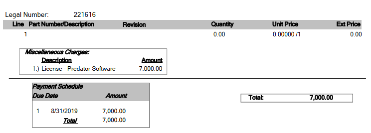

Is it possible to use Misc. Charges for such activities.
Vinay Kamboj
100x this. Fake line items are a bane of my existence and I actually added BPM’s to block people from adding them. Fake items are just a really lousy thing to do when you have this built-in option on the next tab.
We skip the order entirely and just notify accounting to create a miscellaneous invoice with one line, (leave part blank) qty 0 with a misc charge on that line for the service. Might not work for all use cases but after lots of aggravation seems to be the simplest.
