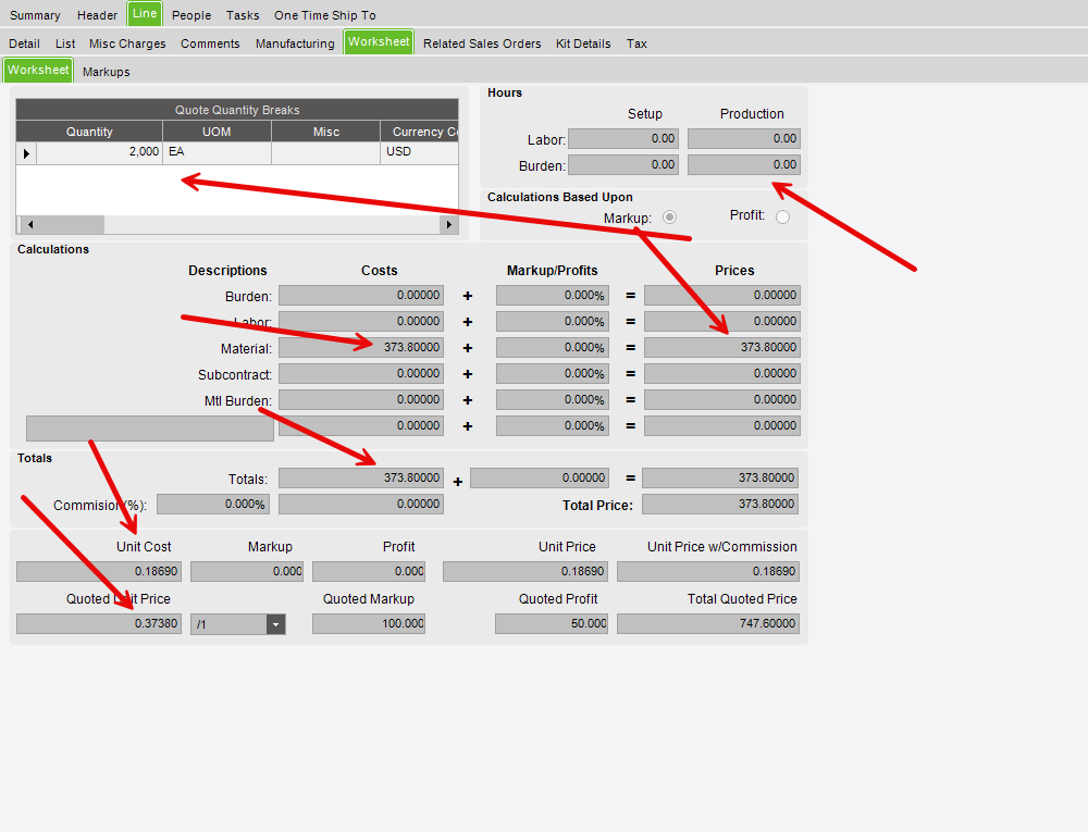

  1. Quote Worksheet Recorder
    • These values on the worksheet aren’t stored anywhere; they are “rolled up” from the Quote BOM. I need this in reports and other places, and rolling it up manually is painful. Enter my QuoteQtyMaint BO, which has all those fields in a new table. When an entry/change occurs in QuoteQty, a function is invoked that performs a QuoteGetByID and then loops through the Worksheet dataset, recording all these values in a neat package for further use.
    • Could I do it without the SDK?
      Sure! But the table would be called UDXX, and the fields would be named MyAwesomeFields_UD, which makes the code less clean. I named the fields exactly like the original dataview, allowing for a BufferCopy to copy all fields at once — #Neat.

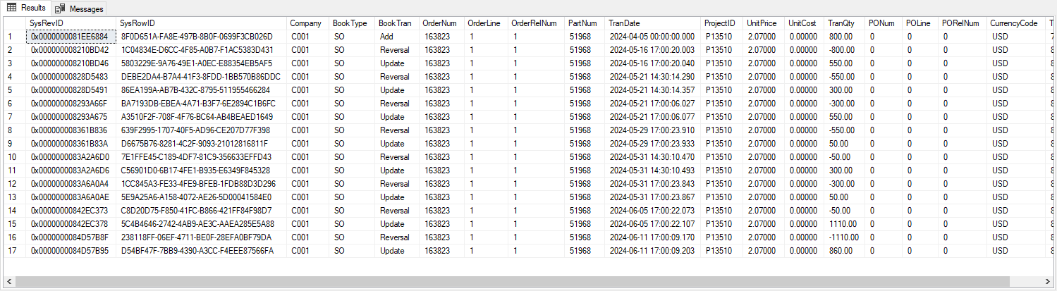

  2. BookerService
    • Are you familiar with Order Bookings? If not, you can skip this.
      Order Bookings is a functionality in Epicor that forces Sales Orders Lines/Releases to “record” bookings (i.e., changes in revenue, up/down).
    • Every time a line/release changes either quantity or price, a booking is recorded. This allows you to track sales trends by monitoring activity fluctuations. Although I think it’s a flawed measure, my company disagrees and wanted to use the Bookings functionality. However, due to some issues, such as bookings not being recorded if the order isn’t set as ready to process or other minor actions, we found it unreliable.
    • Therefore, we developed Booking Service — a BO that records revenue (or cost) fluctuations for Sales Orders and/or POs. When a new Release is added to a SO or PO, it records an “Add” transaction. Subsequently, any changes in quantity or revenue are tracked by recording a “Reversal” and an “Update” with the new values, allowing for tracking value fluctuations over time.
      Yes, for the same reasons as above.

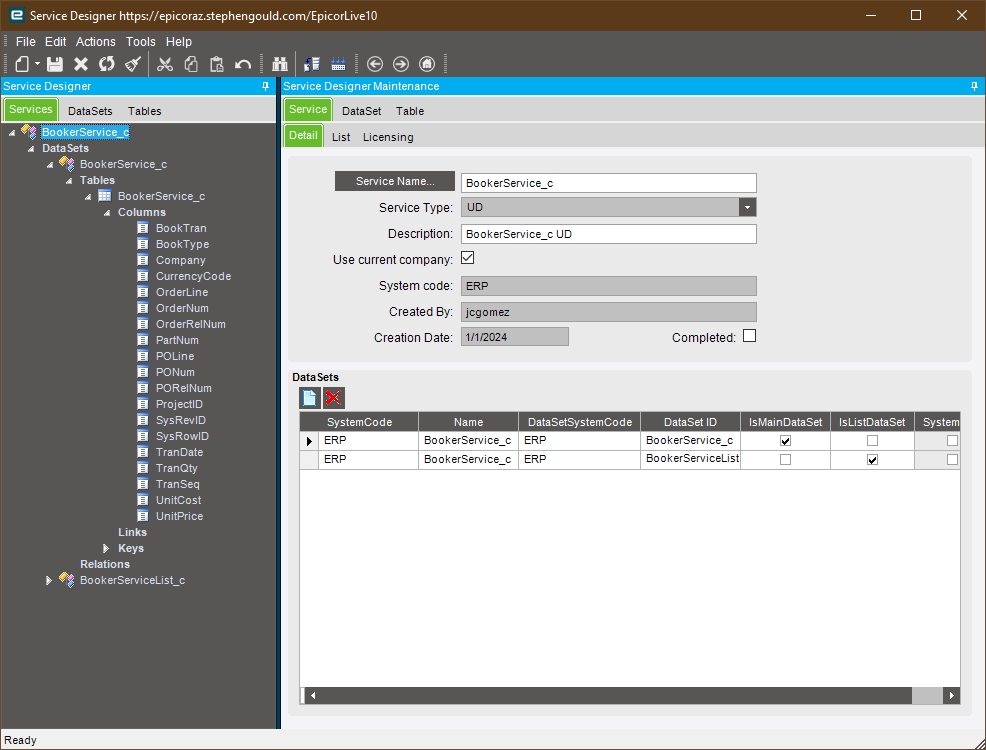

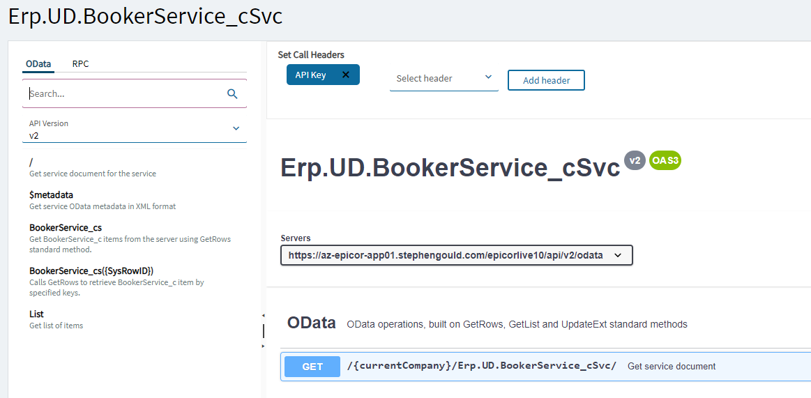

Here’s how the BookerService “BO” Definition looks (its pretty simple really)

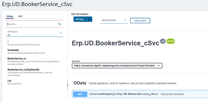

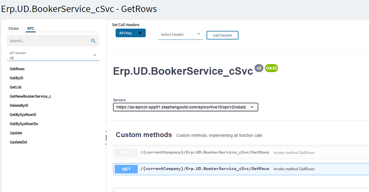

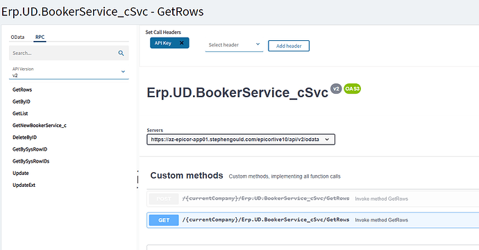

You get OData and Rest Endpoints

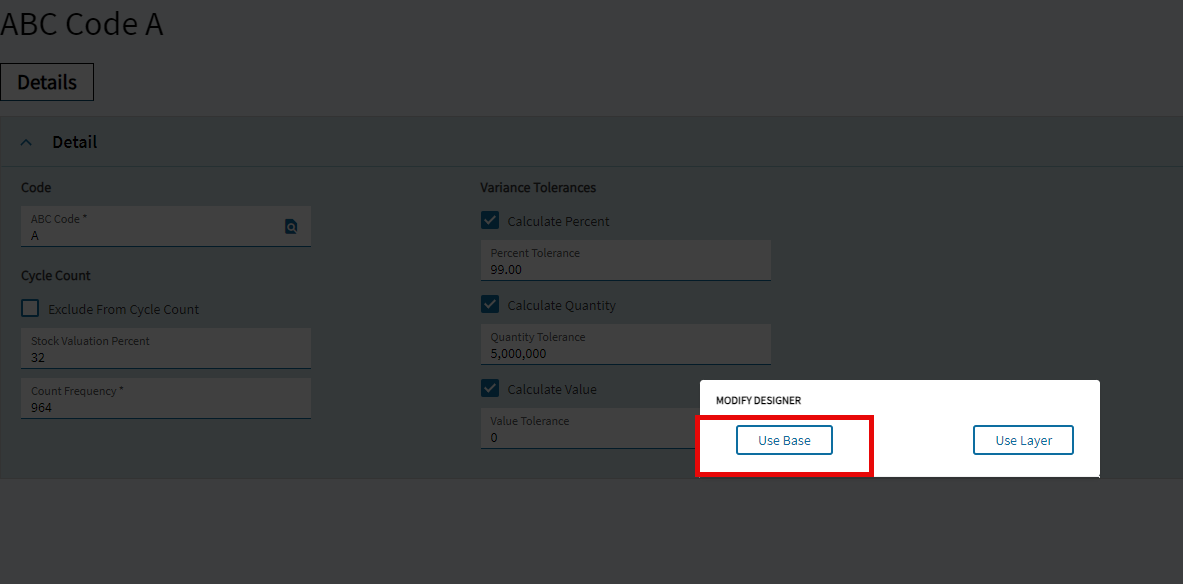

Oh.. yeah and I forgot, you also get to Look At / Modify (don’t do that..) the Epicor BASE Layers on the Kinetic UX App…
Wanna change the way that Order Entry UX works in its entirety? GO FOR IT… (just don’t call me after you break it)
And you can make your own “App Studio Apps” for those new BOs too (but you can already do this sorta with Dashboards and whatnot)
