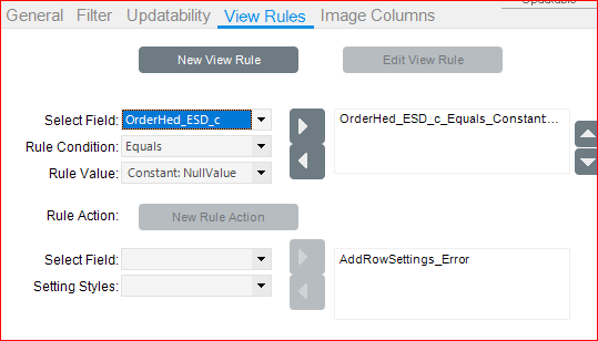

Does anyone know how to set up a rule to highlight a row in a grid when a date field is empty/null? I can get it to work for any other type of field except dates!
According to the manual, you need to set it up like this (leave the value blank) but it doesn’t work:

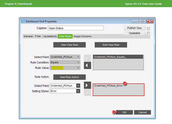

From the manual:

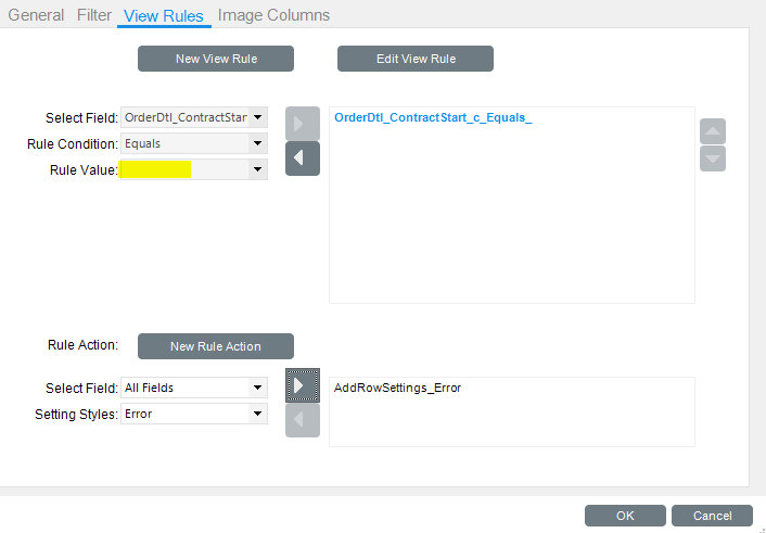

I recently found that “Contains ” Null may work for you. Test it out and see.
Change your operator… Try CONTAINS a value of null
[image]
Result:
[image]
