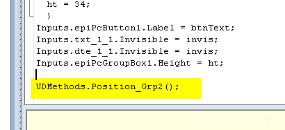

Then in the button for grp1, just call that UD method after grp1’s controls have been hidden/shown:

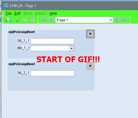

here it is in action:
