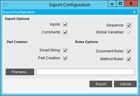

We have created a configurator in our TEST environment and attached it to a test part. Our plan for moving it to the PROD environment is to export it from TEST, import it to PROD and attach it to the real configurable part in PROD. In order to test the process, we exported it from TEST and changed its name to ConfigForImport. Then we created a new test part that has exactly the same MOM as the one to which the original configurator is currently attached.
When we did the export, we checked all the boxes.

When you exported the Configurator did you make sure to select all of the appropriate Export, Part Creation (Smart String), or Rules Options?

Yes, every checkbox was checked when I did the export.
