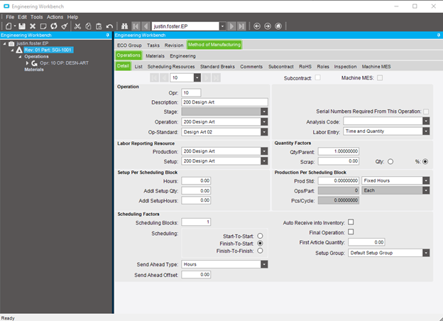

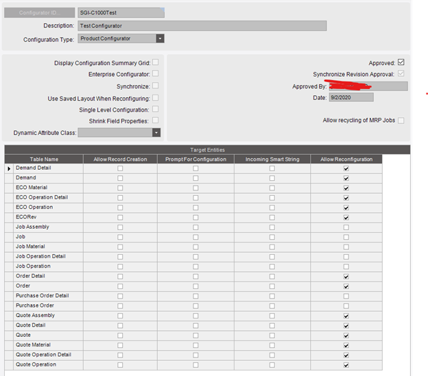

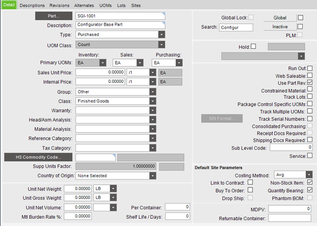

I am stumped. In an effort to make this easier to follow, I setup a test to determine why Configurator will not up keep operations for a configurable part for a quote. This setup will, however, update the quote line item quantity via Document Rules but the operation doesn’t get included. I must be missing something simple. Any advice would be greatly appreciated.
I have checked client side trace and server side logs and there are no errors reported.
Screenshots of the setup are below:
Part -

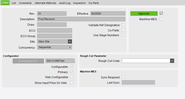

Part Revision -
Engineering Workbench -
Configurator Entry -

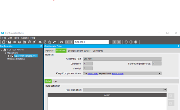

Configurator Rules -

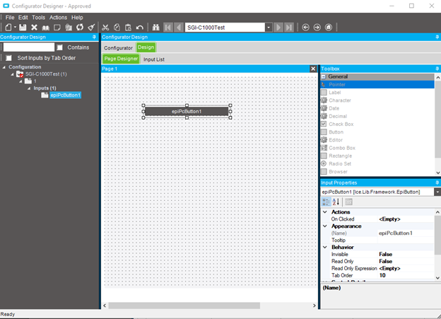

Configurator Designer -
Thanks!

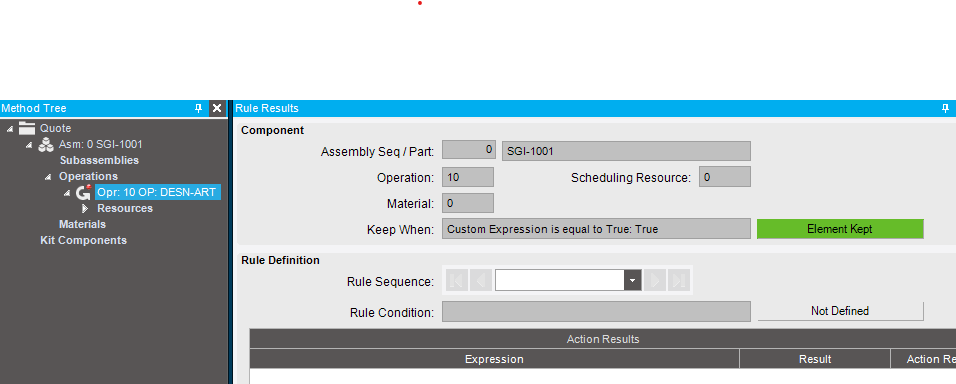

OK… so have you tried running the “Test” when in the Method rules to see what it keeps/doesnt keep? There is a combo at the top of the test results that allows you to choose Job vs Quote.

It works correctly in the Test Rules. I should have mentioned that.
