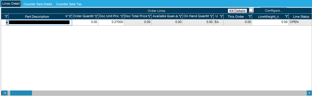

Hello to everyone here at E10 Help I am in a bit of a pickle. I am working on creating a new configurator for the business from scratch and I have got most things working correctly. One of the outputs of the configurator is to save the weight of one configured part to a UD field called LineWeight_c on OrderDtl. I cant figure out a good way to get this value to update accordingly when the order quantity changes on the line.
I was thinking the easiest way to do this would be to have a UD field that stores the weight of one configured item. Then I would have a BPM that runs when the quantity is updated to multiply the per item weight times quantity to then insert back into the LineWeight_c field. Am I off base here or is there an easier way involving the configurator that I am not considering?
