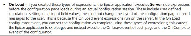

I was reading through the configurator technical reference guide and I came across a section about the On Load event for the configurator and in that section it says that we can, “set the configuration as complete, [which causes] the application to skip pages and instead execute the On Leave event of each page….”
So… my question is, how do we “set the configuration as complete?”
Please see the attached excerpt from the 10.2.300 configurator tech ref guide on this.PNG
