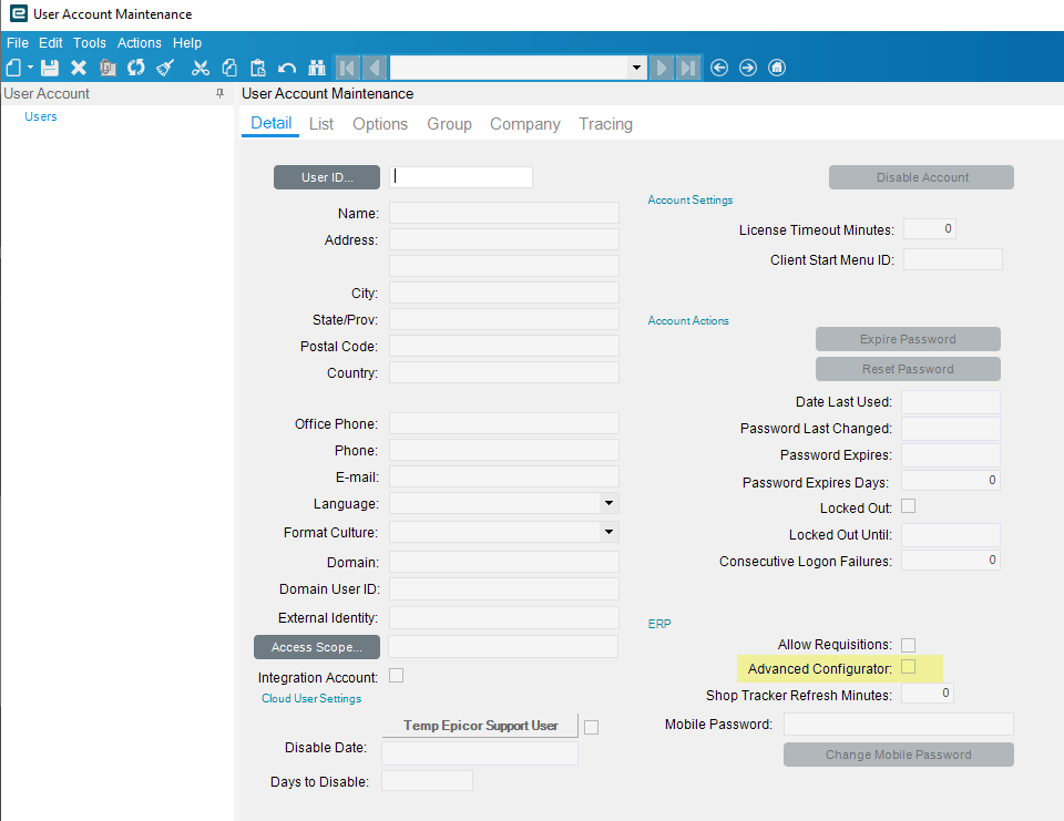

Can you check in User Account Maintenance if you have the ‘Advanced Configurator’ checkbox enabled?
Thanks Mark & Brian.
The issue here was a lack of understanding the differences between the SaaS Options. I thought that Public Cloud was the same as Multi-Tenant. Thus, I didn’t even think to check if this field was flagged true.
But we have since now done that and we can enter in the server side code as expected!
