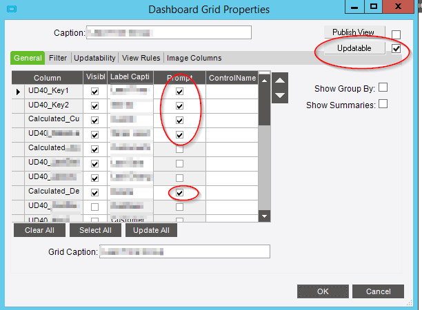

This is my first updatable dashboard. Everything works in the uBAQ and when I run the test in the dashboard before deploying I can’t get it to work. I have the updatable checkbox on the dashboard checked. What other boxes need to checked?
in the Grid Properties (right click on the grid view of the dashboard), you have to select the Updatable AND he prompt fields to make them updatable… Then you have to deploy it.
Thank you so much for all the help. I was able to successfully deploy the dashboard and it works great.
