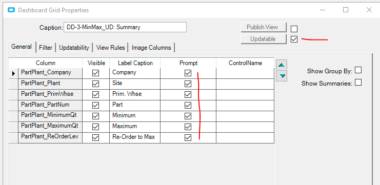

Does anyone know why I can’t tick this tickbox? The BAQ is updatable with those fields selected as updatable.

Is the Grid checked as Updatable in the dashboard and the fields checked as prompt ?
It also needs to be a deployed dashboard. Check that from Menu Maintenance you’ve got it selected as “Dashboard Assembly” rather than runtime.
