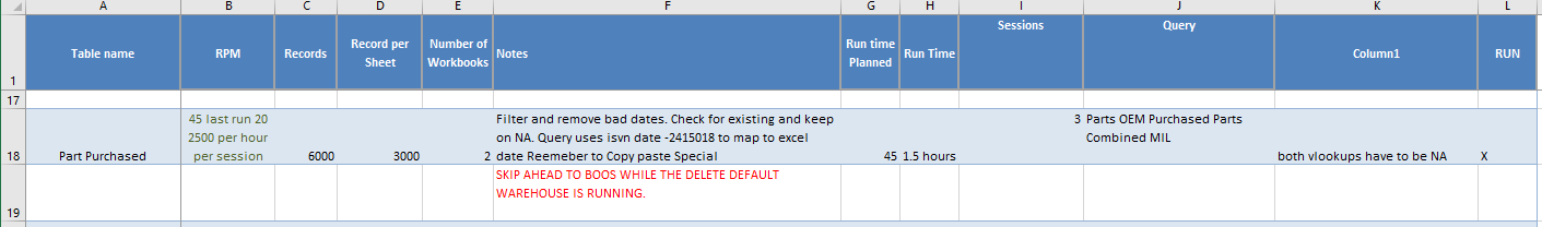

I would suggest making a script and practicing the DMT process. Launch several DMT sessions on the machine until you see the RPMs start to decline. Keeps notes on small things you forgot in a run so that you do not do the same going live. Here is a snipit of my DMT plan. We kept building Pilot with static data company configs, customers, vendors, Parts, boos, boms and then I would only update changes. Move that to live and then update transactional data there.

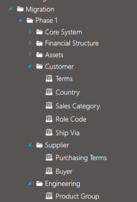

It looks like someone has put together some of this in the Migration menus in DMT. You are all the way to phase 4 before you actually load a customer record. you could use that as a roadmap for data loading.
Ooof…migration menus in DMT is news to me, but I just found it. All this time I’ve been looking at this and didn’t realize there was another menu format…
I wasn’t aware there was a migration menu…a quick skim through the phases and I can see I have a lot more to consider than I was aware, although many of these might not apply. Task sets for example.
