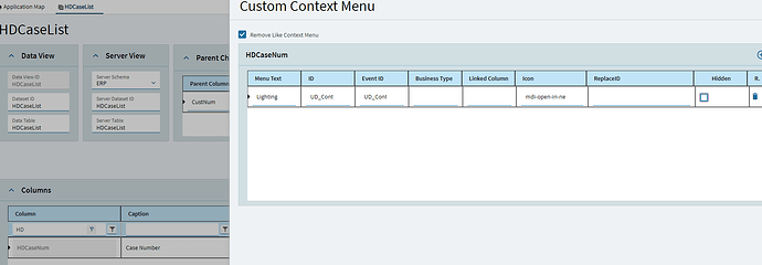

Hi, I am trying to add a custom context menu to a grid.
I have added the context menu to the field through the data view.
I created an event (event ID added to the custom context menu)
The Launch options are:
"options": {
"valueIn": "{HDCaseList.HDCaseNum}"
The slide out panels opens after clicking the context menu option but the case number doesnt populate with the valueIn value.

This may still be broken. It was for some time.

Does anyone know if this is still broken?
