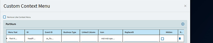

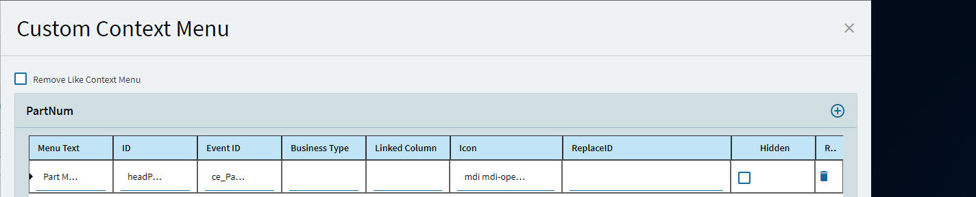

Give this a go, it is an older post but may still be relevant. Newest version of Kinetic context menu maint is still worthless from what I’ve run into. TransView this is probably the only way to go
Add the Context Menu Item to TransView.PartNum

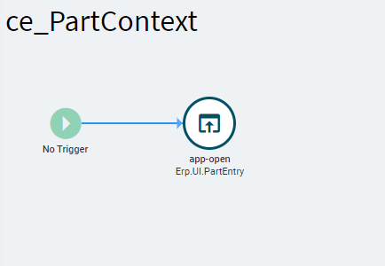

Created event
Still doesn’t appear?

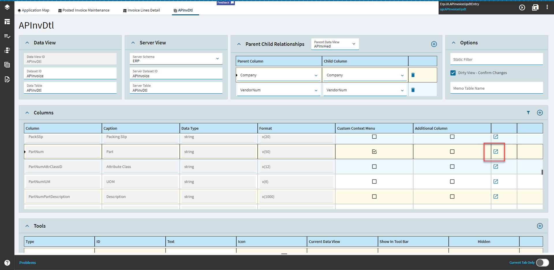

Any ideas? @hmwillett do you have a stick to poke it with?
I was trying to add a context menu to a column in a custom data view yesterday. Does not work for me either, guessing another bug
