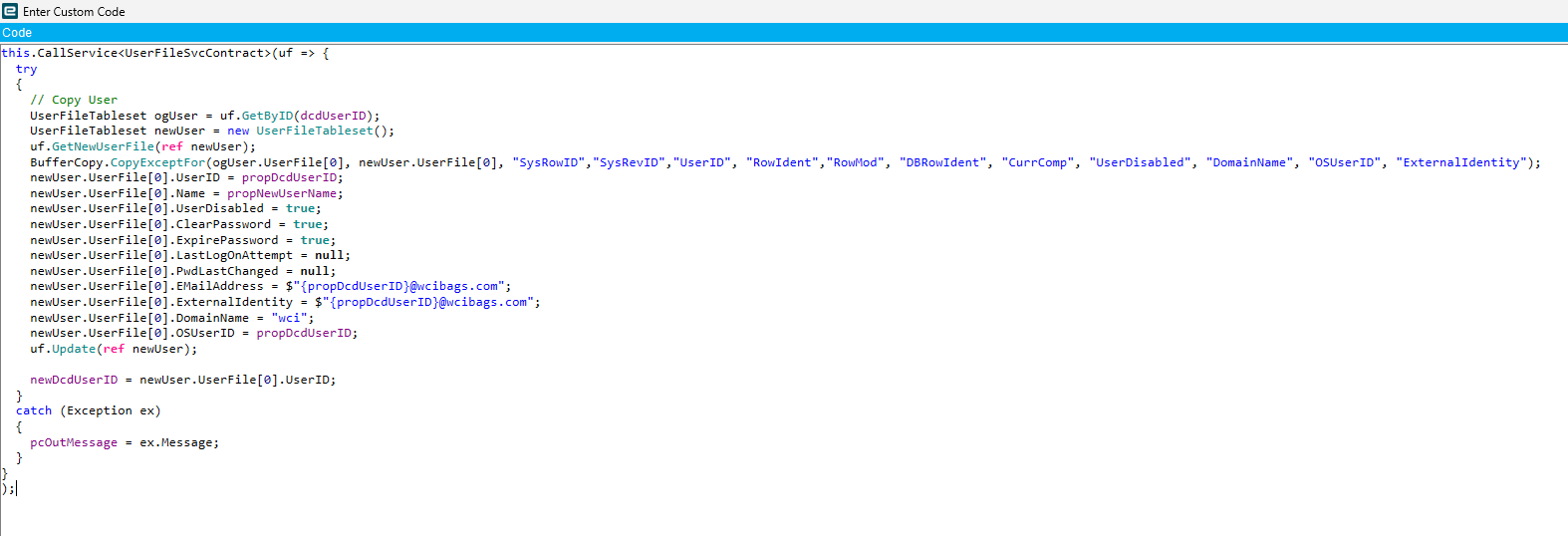

This is an example of the buffer copy I was talking about. This is how I created a Copy User action in User Account Security Maintenance.
This seems like the path I am looking for…Would I be able to access the XFileAttch table using this? @jgiese.wci
Of course!
