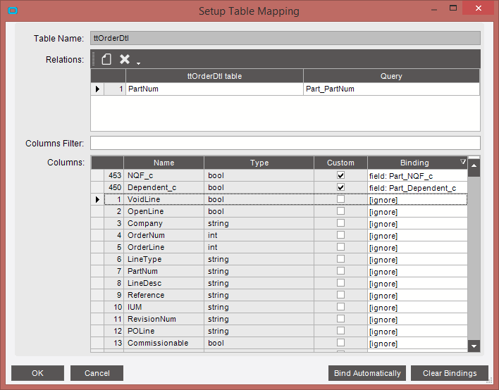

I my case, I wanted UD fields from Part to pass to OrderDtl
in SalesOrder.Update, Pre-Processing, put a Update Table By Query (just Start > Update Table by Query)
Configure the Update Table By Query with 4 params:
Use the MyQuery query parameter to make a BAQ from Part with Company and PartNum, plus the two Part UD fields I want to go to OrderDtl.
Query to Update changed rows
of ttOrderDtl table with…
Configured mapping
in relations, set the field that will be the match. In my picture, ttOrdreDtl.Partum will match with my Query’s Part_Partnum
and the column OrderDtl.NQF_c will match with my query’s Part_NQF_c
and OrderDtl.Dependent_c matches with query’s Part_Dependent_c

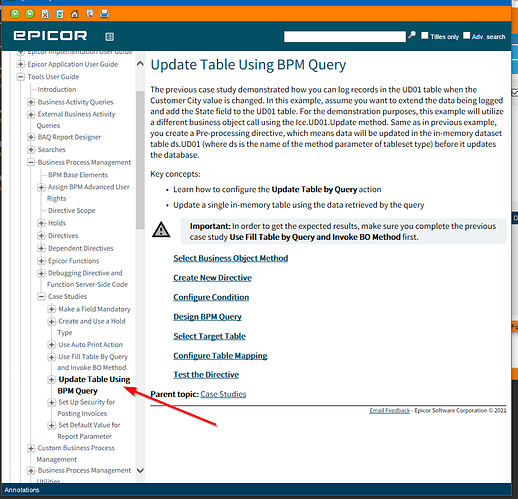

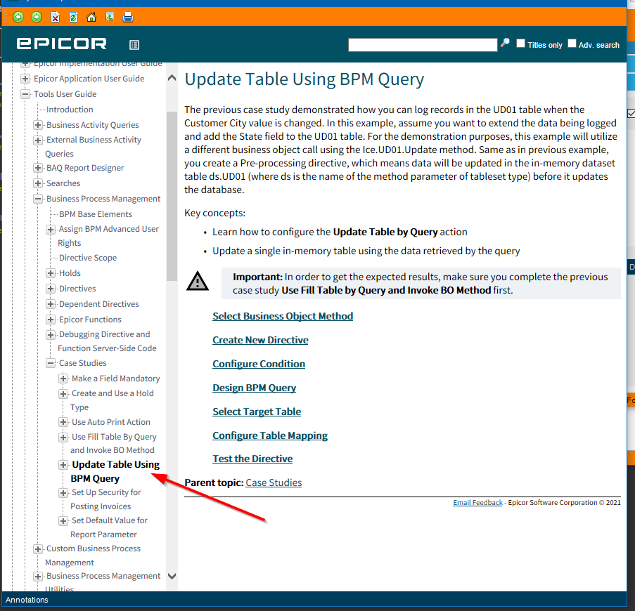

I don’t mean to be rude, but from the questions that you are asking, you need to get some basics under your belt before you attempt this.
Go to the tools user guide and read up on BPMs. There are even case studies that walk you through some cases step by step. The one below looks like it’s pretty close to what you are doing.
So I went through this and followed it step by step. Should updating the field also update the column in the list view?
If it actually made the change, then yes. At the very least, you might need to hit refresh on the screen.
If it doesn’t work, then drop in message boxes in your method and make sure it’s firing.
If it’s not. Then you need to run a trace to see what methods are being used so you can put your BPM on the right method.
