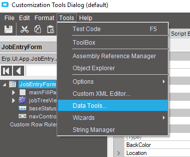

I am in the Customization tools dialog. I don’t see a foreign key view wizard. It sounds like what I am trying to accomplish. Could you elaborate a little? I’m learning so many new things lately!
You can bring in other data tables into your customization with it. I had issues with using the order line and order rel fields as foreign keys to link with the OrderRel table, so the data directive may be a better solution.

This can be done with a Foreign Key View, you just have to create 2 FKVs.
First one is a parent of JobProd, linked to order num, type of Foreign Key View. Select OrderNum for the Like Column.
The second is a sub table view, with a parent of the view created above.
In the subtable view you add 3 Parent / Child View Columns, OrderNum -> OrderNum, OrderLine -> OrderLine, OrderRelNum -> OrderRelNum.
You can keep your data in one spot, reference it any where else and not have to worry about BPMs to sync.
