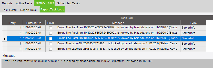

First time I’ve ran into this error. Have an intern helping in accounting, he ran Capture COS\WIP process a couple days ago and now we’re unable to run it due to some records being locked. Could anyone point me in the right direction?

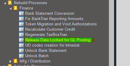

Run the conversion program - Release Data Locked for GL Posting
