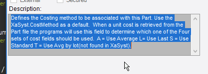

PartPlant Msg: In Part Site, the Lot AVG or Lot FIFO Costing method requires Lot Tracking. In Part Site, the Lot AVG or Lot FIFO Costing method requires Lot Tracking.
I used a T in the cost method field for Standard. I changed it to L and the upload when fine but curious why. Would think Standard should have worked, perhaps I should have left it blank or T is invalid.

Standard is S. I think you just read the field help wrong. T is average by lot.
