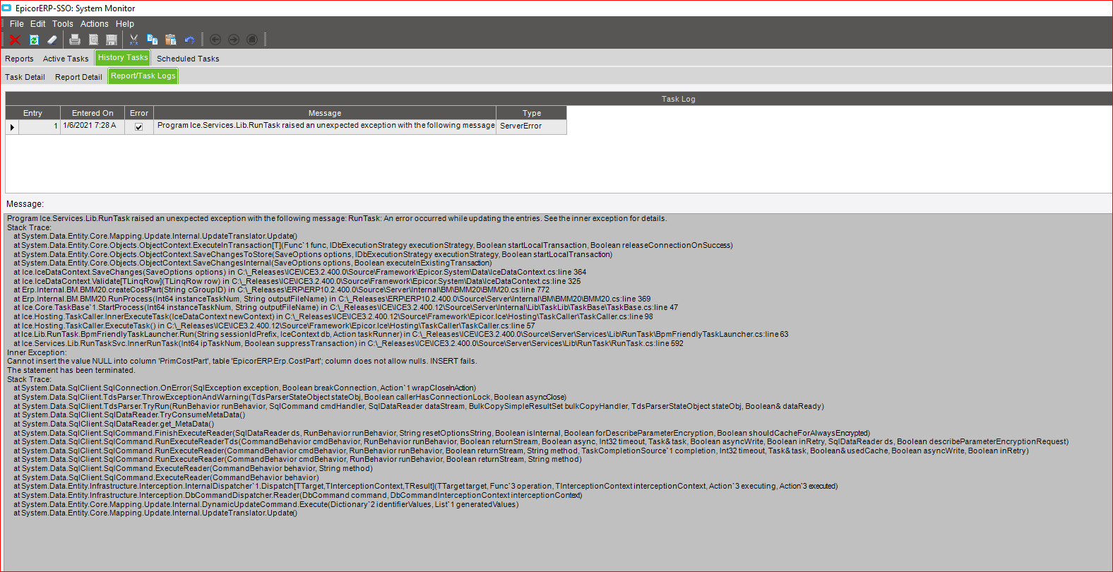

We encounter this issue on December 31 where I wasn’t able to upload the cost into the costing workbench using the Actions>Load Cost Details.
The error below didn’t let any of my parts cost to be upload, and for these reasons I wasn’t able to do my cost roll-up.

I’ve run into this issue where parts where missing a part cost id.
I think epicor support had a datafix, so I didn’t have to get creative to fix.
Thank you for your message, How long toke Epicor to fix this issue for you?
same day
Thank you @bderuvo but it was parts that we already roll-up before, All the parts has part cost id.
