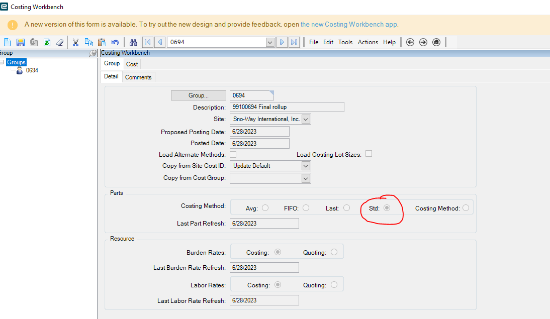

Are you Std Cost, Last Cost, Ave Cost ?
Backing up a bit, did you ever run the Print Cost Set from Costing workbench?
We are using standard costing; I have not printed the cost set from costing workbench.
Good, that’s easier. Its going to take some legwork to find out why the difference in the costs. My first step would be to see what changed— from the cost set.
I can not tell you with any certainty where the BOM Cost Report gets its data. I do know the Costing Workbench gets its costs from the methods defined in Engineering WB. This would cut down on what to look at.
Refering to What Mr Taylor said before, you could have mistakenly selected Last Cost or Ave cost when you processed the rollup.
You can easily re-roll and look again and post again.
Just create a new costing group and do the exercise again.
Check the costs before you post the group though. If you would have checked before the posting you would have seen that something was off.
