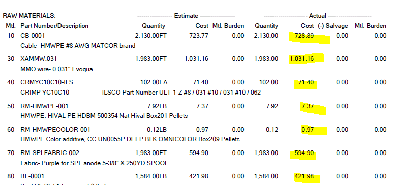

OK, i looked up an average costed job that is shipped but not yet closed with Prod. Qty of 1 and “Qty Completed” of 0.
The results were similiar to yours. It looks like it is using the “Qty Completed” field to calculate cost. I use a modified version of Prod.detail report, so i never saw this before. re-wrote the whole report in crystal reports in Epicor 9 and carried it over to E10. but it seems like the SSRS report in E10 IS using Qty Completed to calculate Unit Cost.
Formula for Unit Cost from Production Detail report:
if {JobHead.QtyCompleted}=0 then 0 else
{#Job@TotalActCosts}/{JobHead.QtyCompleted}

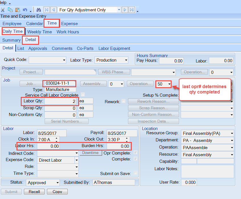

Labor Qty procedure to correct the qty completed
Go to Job Management > Setup > Employee
We setup an dummy employee called “QTY Adjustment” with $0 labor rate.
Go to Job Management > General Operations > Time and Expense Entry.
enter the employee id then go to new Time detail from drop down
Then enter the job number, Asm, Operation (last opr on job) and Qty to be completed.
MAKE sure labor hrs and burden hrs are 0 since you dont want to add hrs but only complete the qty.
Time and Expense entry will do this as well as MES.
