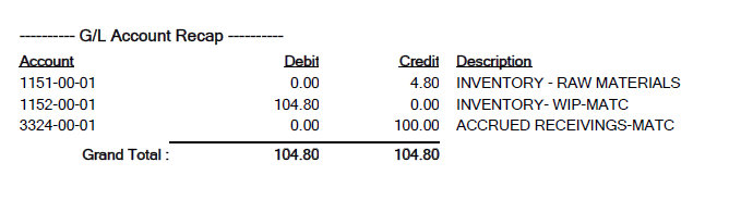

John - the main point of the OP is that doing a partial shipment of a job, temporarily throws things off.
I actually ran the example I made above (with the exception of the cost of the stocked part, in the MOM)
I do not see anything hit COS, until after the rest of the job ships (and is invoiced)
WIP RECON after the first 5 were shipped, invoiced and Capture COS/WIP was run:
Notice there is no entry for COS
After the remaining 5 from the job are shipped, invoiced, and Cap COS/WIP was run:
There is now a COS for the entire Job Qty
If that second shipment never happened, or only 4 of the remaining 5 were shipped (and the Job remained open), the COS would have been orphaned in the WIP account.
