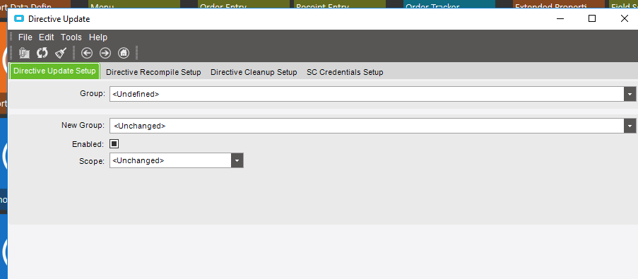

I’ve just tried to open up some BPMs (MD and DD) to check if they survived the upgrade… but I get the following error
After I close the error it leaves a blank BPM screen
Has anyone got any ideas??
