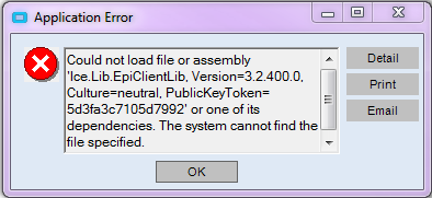

We have 10.2.500.10 installed on our Test environment and so far everything seems ok apart from none of our BPMs work. We are getting the error below;

That is a Client Side Error and your Auto-Update must have failed or your files were only partially updated.
You are trying to use a 3.2.400 dll. Reinstall your Client. Get a fresh copy of the latest client installed.
Ah, thanks @hkeric.wci
I should have said that I could not open them in the Directive Maintenance. I will re install the client.
Thanks again.
Adrian
I’ve had something similar where I couldnt open the BAQ Designer and somehow the dll was mismatched, after a clean install it worked.
