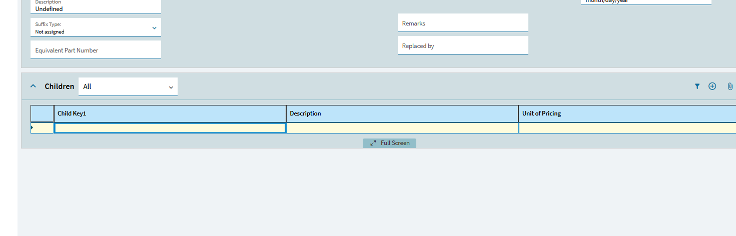

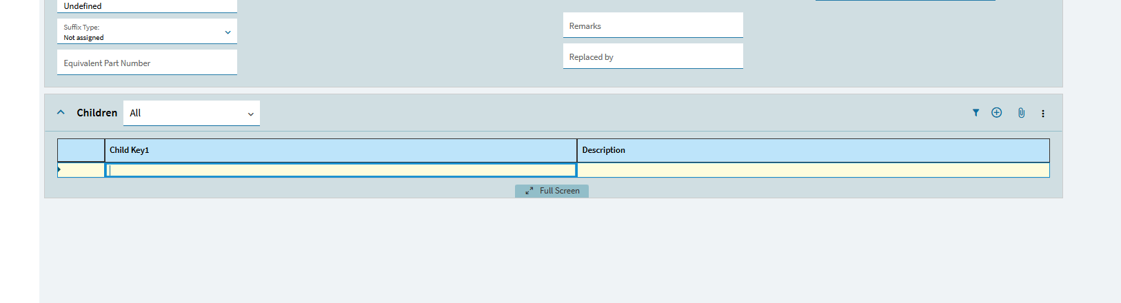

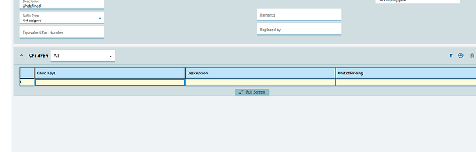

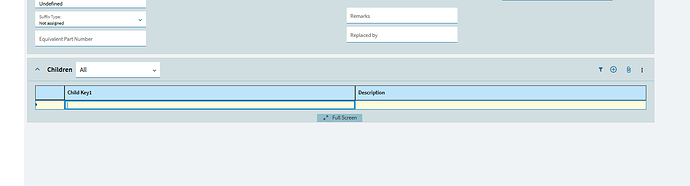

How can I create a dropdown list in a grid.
Refer to Page 45 of the Kinetic Application Studio Reference Users Guide.
@Hally Thanks
I am bit confused. Page 45 is about the layout. I want to populate the list below in the grid, so when I click the on the, list populated and the user cannot enter any other value.

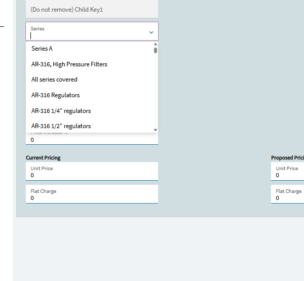

I think this post may help
thanks you so much @Hally, it worked. I used BAQs and UD codes to populate the list.

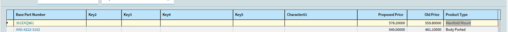

@Hally I am trying to use the same logic to create a drop down on homepage of a UD29 table, but that doesn’t work.
Is it not supposed to work there?
