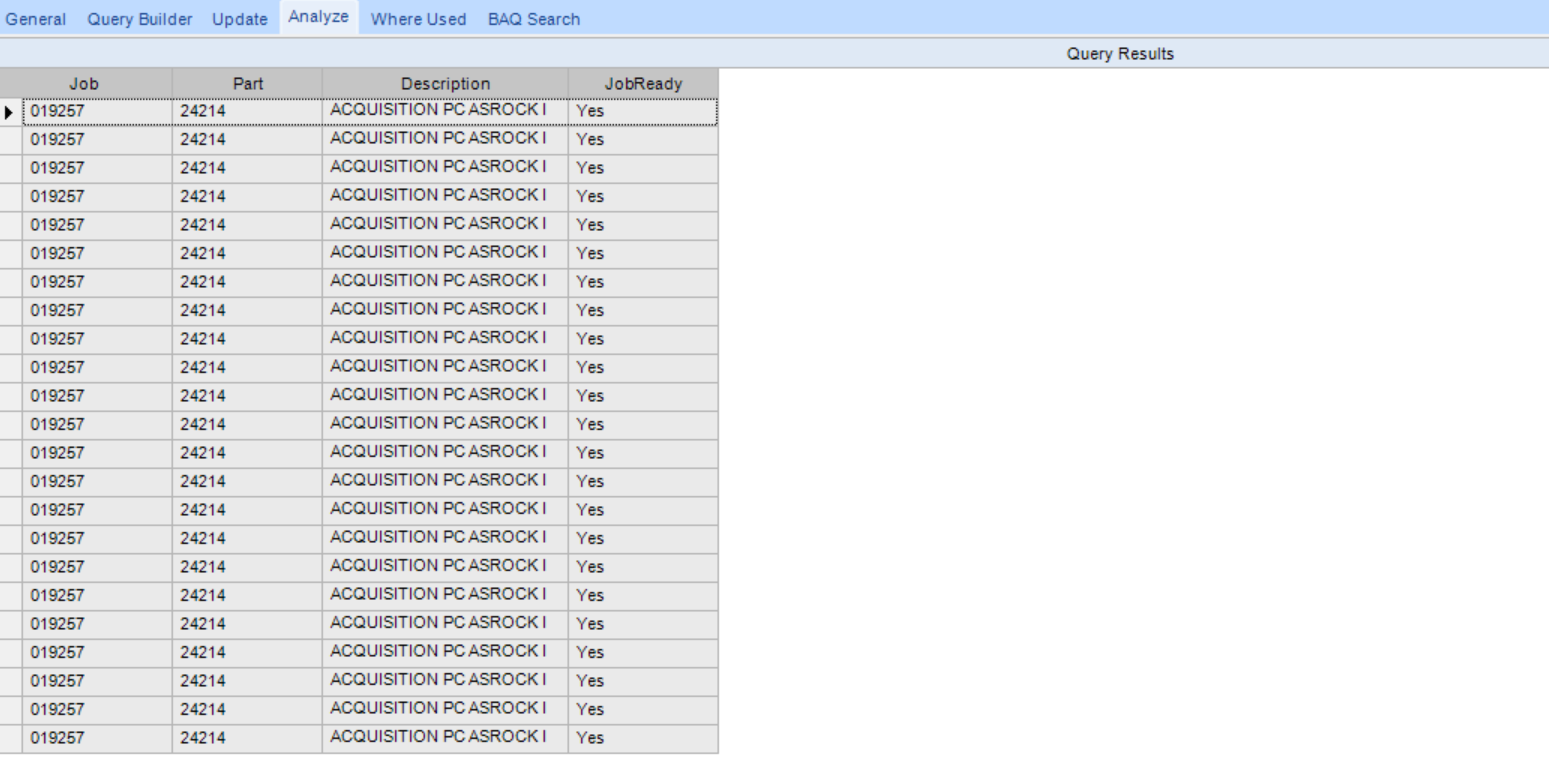

Thanks, I’m slowly getting there. I have made the calculated fields and they are all working. Now trying to work out how to make the below a single row return. Currently its duplicating for the amount of material in the job even if I remove those fields.
@Rglancy Are you grouping the sub by company and jobnum only?
then you join that to the main by company and jobnum and you should get one row per job.

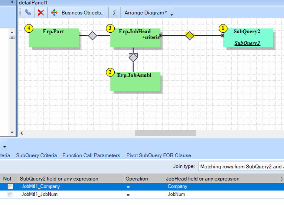

I took out JobMtl from the top query(that is all of the lines) Added company to the Subquery because it should always be there and joined the sub to the main inner joined like below. I would also as good habit make the top query something like Top or Main and I tried to change subquery to MtlCounts, but it was already in use, so I would have ha to remove your calculations and put them back… I also took distinct off since if you do the joins right you would not need that overhead.

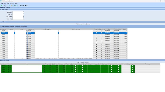

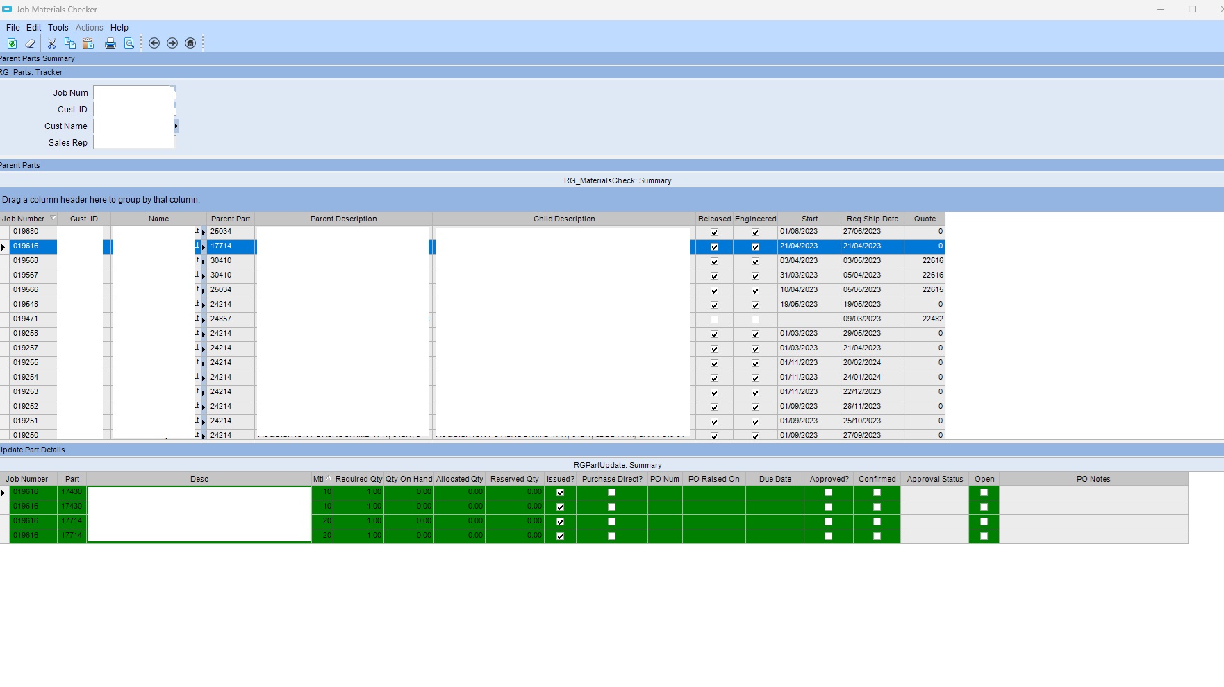

The plan is to have the job line go green when all materials are issued (I have this resolved)
Amber when we have the materials in house (allocated or reserved but not yet picked)
and Red when there is a confirmed material due date which is later than the job start date

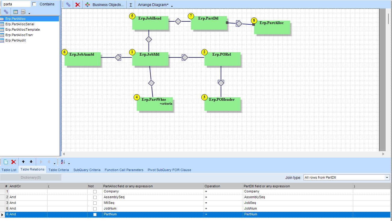

Yup,found that but have a problem.
I am linking it to JobMtl using company/Jobnum/Partnum/Assyseq and have selected a part from the job and only allocated material to that one part. Now my results are just that one part which has allocated material, but I want it to show all of the parts (the rest should just say zero)
frying my brain!
Hi Ricky,
Sounds like you need to change the join type between JobMtl and PartAlloc to ‘All rows from JobMtl’, you do this from the ‘Table Relations’ tab. I’ve just had to something similar for a query I’m working on:
Thanks,
Nathan
Thanks, tried that and its returning no data in the allocated materials but everything else is still fine.
