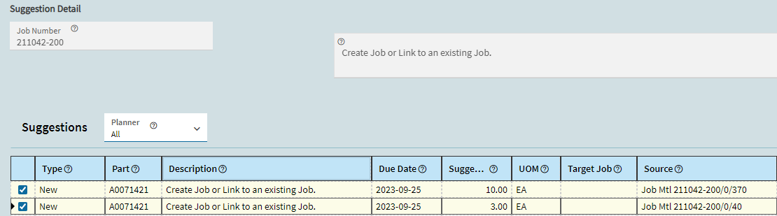

Does anyone know if there is a standard process to create a single job from multiple job suggestions? The result would be a single job with X number of demand links.

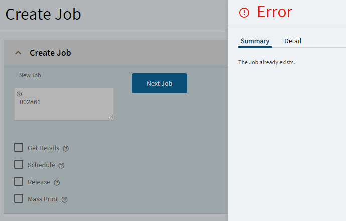

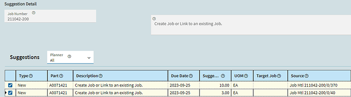

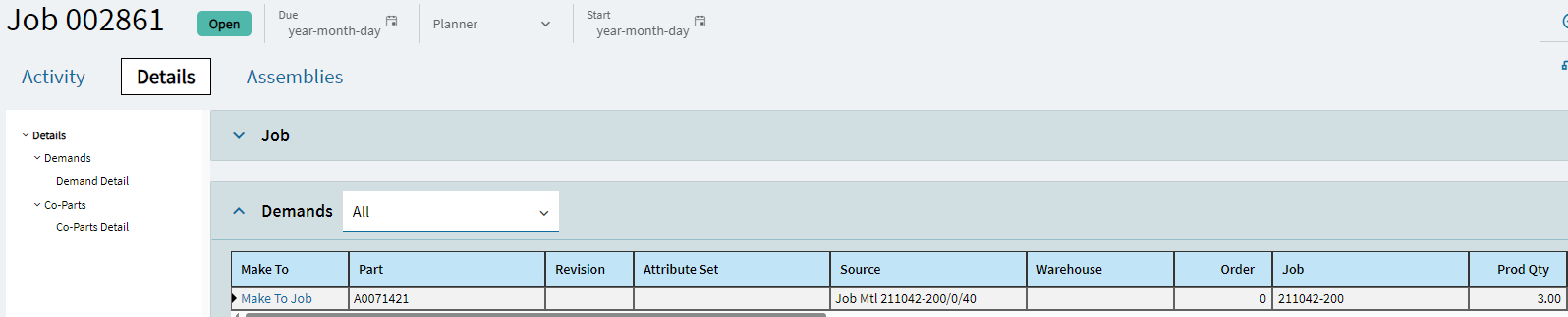

I tried using Planning Workbench to select 2 new job suggestions for the same part. When I attempt to create a job, I get an error “The job already exists” and it only creates 1 job with 1 job demand link.

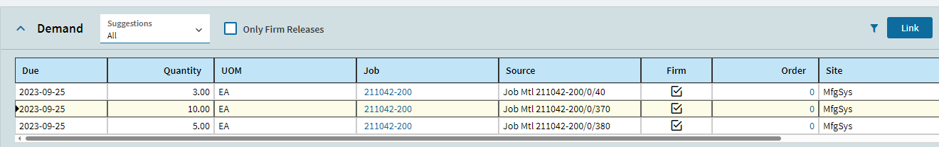

Job Manager is Part driven. You should be able to link all demand to one Job in that screen. If I am remembering correctly, you can even create a Job from that screen.
You’re right, Job Manager is part driven. You can link all your demand to one job, but it still requires you to do this link by line. There is no checkbox to select multiple suggestions.
