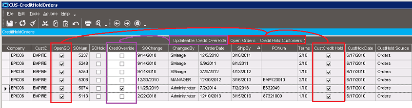

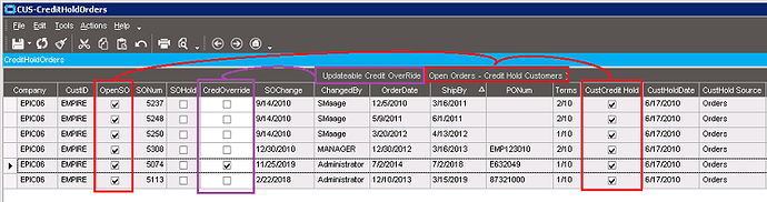

If currently using Customer Credit Manager only to manage Sales Orders, I might add an updateabel BAQ before I’d try automating SO creditoverride settings. (assuming you don’t already have UBAQ).
Once you’ve identified all existing components and conditions, you should then be able to add automation - BPM triggered when Customer.CreditHold changes from False to True.
Sample below of simple UBAQ to list open orders for credit hold customers - where the CreditOverRide column is updateable. Can be a little easier than using the Custom Credit Manager.
