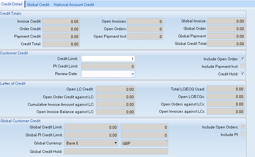

In Financial Management > Accounts Receivable > General Operations, use the Customer Credit Manager to release individual orders from credit hold.
As said above you have Credit Hold and Order Hold - on the Customer and OrderHed Tables respectively.
There is functionality called ‘Credit Override’ which is for creating an exception, per order when a customer is on credit hold. Between these two methods I am sure you will find what you are looking for.
Regards, SD
i think that is what we want…where will i find “credit override”?
Bottom of the Header page.

Accounts Receivable > Customer Credit Manager
