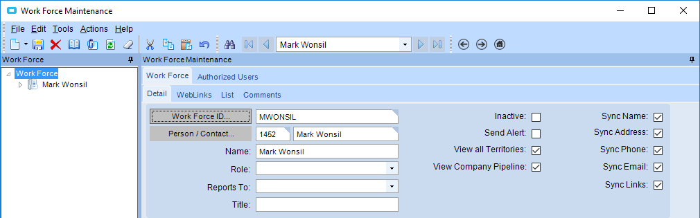

As for territories, if you don’t mind everyone seeing everything, just click on the View All Territories checkbox.

If I set the “View All Territories” on the Workforce, will that enable that use to be able to update tasks in territories that the user is not specifically defined as a Salesperson for? That would be ideal…
I am thinking of getting rid entirely of the “authorized users” on each workforce (only setting the user as the workforce auth. user) and then defining the territories with a single “primary” sales person
So visibility is one thing but approving tasks is based on the Role. Your task has a role that indicates who can approve the task. Just assign that one role to all users and all of your tasks. That would give everybody the ability to approve any task. Does that make sense?

Yes, all the workforce would have the same role, so that should work. I just want to make sure the territory structure would also work, i.e. not requiring adding every possible sales person to each territory
