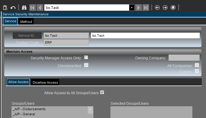

Mike - Take a look in Service Security Maintenance and see if one of the Task business object methods has ā€œsecurity manager access onlyā€ checked. We had a similar issue where only a security manager could delete a lines on sales orders during our 10.2.300 upgrade testing.
I’m not sure if this is the right one below:
