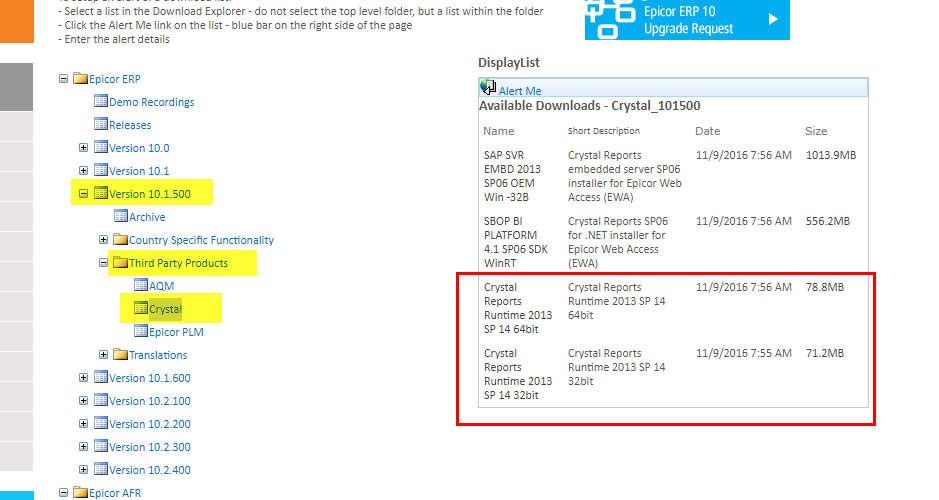

Is the CR Runtime installed on the client?
edit:
The CR Runtime for 10.1.500 is available at:
I can never rememeber whether the bit depth (32 vs 64) needs to match the client O/S, App Server O/S or App Server version
