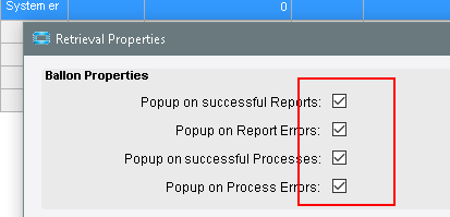

Enable Balloon pop-ups (Actions -> Retrieval Properties), and enable all.
Then run the report again, with the archive set to a week.

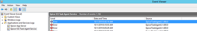

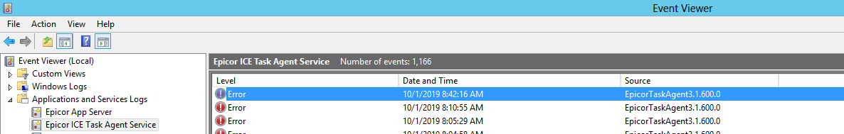

You can often find the System Monitor Errors in the Windows Event Viewer under Applications and Services Logs - Epicor ICE Task Agent Service. Maybe once you can find the detailed error message here it will help you point to the exact issue. The errors anymore are fairly helpful…
Please no comments on how many errors are showing up in my log… :face_with_symbols_over_mouth: :stuck_out_tongue:

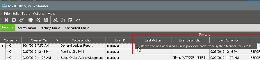

It goes into complete status. The last action reads “System error has occurred! Run in preview mode from System Monitor for details.”

That’s a lot of errors
And when you select that report (the one with the “System error…”) from the Reports tab, and click the preview icon in Sys Monitor, you get nothing?
Yup, usually when a icon can be activate there is an outline around it when you hover over it but it doens’t seem to be enabled when I highlight the row.

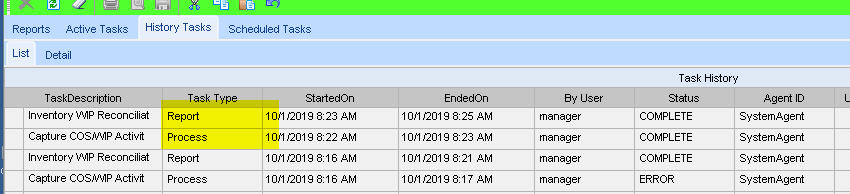

In SysMon, what Task Type does it show on the History tab as? ‘Report’ or ‘Process’

It shows up as report, I also tried to create a blank report with the XML and SQL connections with only one field used in the report and this still happens :frowning:
