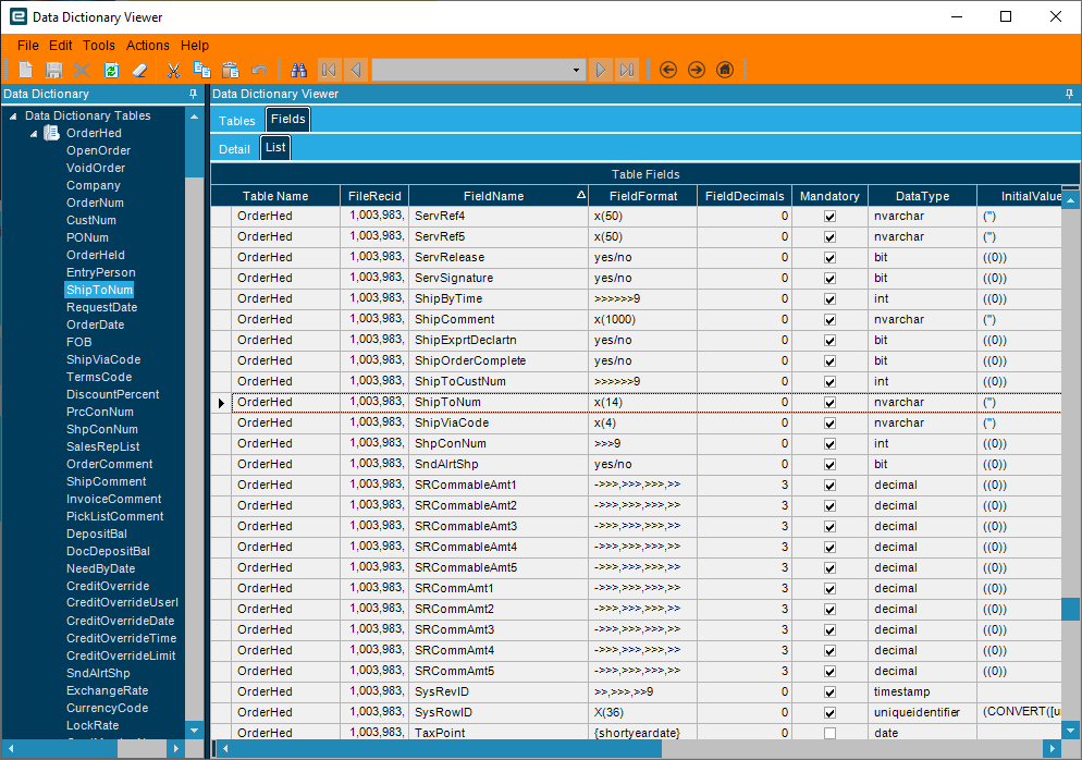

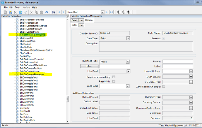

We are in 10.2.700.30, I am working with a Data Directive on the ShipHead table. Copying some Fields and UD fields from OrderHed to ShipHead. All work except for OrderHed.ShipToContactPhoneNum and OrderHed.SoldToContactPhoneNum.
I get this error for both fields
CS1061 ‘OrderHed’ does not contain a definition for ‘ShipToContactPhoneNum’ and no accessible extension method ‘ShipToContactPhoneNum’ accepting a first argument of type ‘OrderHed’ could be found (are you missing a using directive or an assembly reference?)
These are stock Fields in OrderHed.
