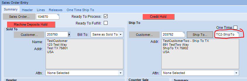

So our Sales orders will sometimes have a different Ship To Customer than the Bill To Customer, and some Sales orders will have a ShipTo record for the Ship To Customer:

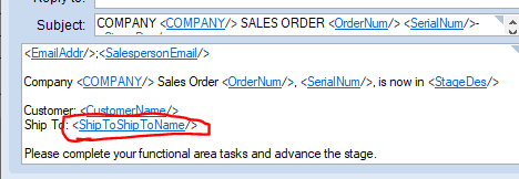

I am trying to show a task owner what the ship to name is:

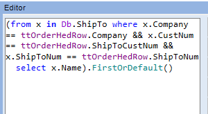

Here is the formula I am using on the Data Directive (for my variable ShipToShipToName):
The formula results in a null value.

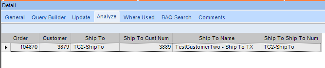

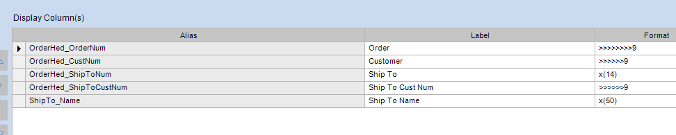

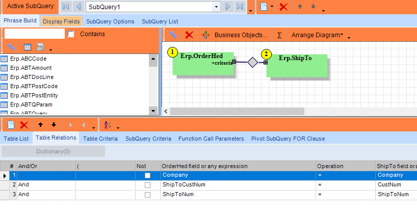

I created a BAQ with the same links:
The criteria on my OrderHed is this particular Sales Order, and here are my display fields:

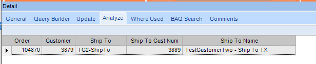

The results of my BAQ are:

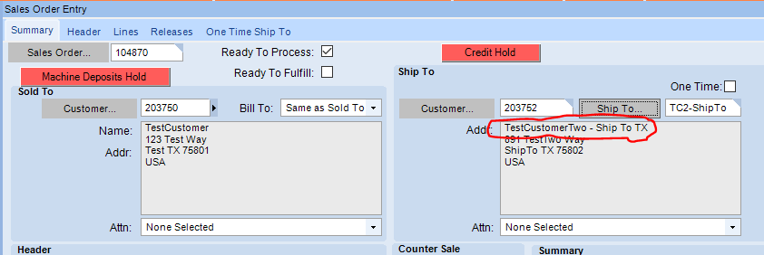

So I am expecting my formula in my Data Directive would be “TestCustomerTwo - Ship To TX” and not be null.
But I get this:

(from x in Db.ShipTo where x.Company == ttOrderHedRow.Company && x.CustNum == ttOrderHedRow.ShipToCustNum && x.ShipToNum == ttOrderHedRow.ShipToNum select x.Name).FirstOrDefault()

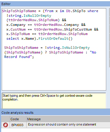

someVariable = (from x in Db.ShipTo
        where
            !string.IsNullOrEmpty(ttOrderHedRow.ShipToNum) &&
    	    ttOrderHedRow.ShipToCustNum != null &&
        select
            x.Name).FirstOrDefault();
someVariable = !string.IsNullOrEmpty(someVariable) ? someVariable : "No Record Found";
Kevin,
I am weak with code, but I get this error when I try to use your code:

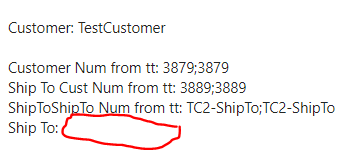

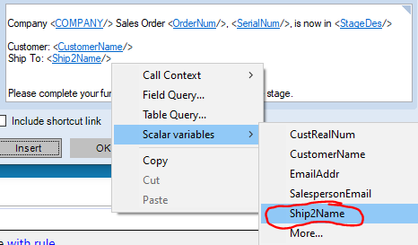

I just placed Field queries in my email message so I can see the values:
And this is the text from the message:
I suspect my issue lies within the formula I am using to find the ShipToShipToName:
But I do not know what the issue is.
Instead of returning just the field, throw the full table in there and see how many records get returned.

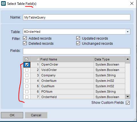

How do I dump the whole table?
same as how you insert a field into the message, except choose table instead of field. should be right above or below the field one.
Here?
If so, you can choose only 1 field:
Yup, select them all to see all of the data and how many records are returned. I have found many times that the tt table does not actually contain the info I am looking for. Or that I am returning more than 1 row.

Success!!! Once I changed my variables (so the variable name did not match a field name), I forgot to change the Scalar variable to match my new variable name. Now that I have fixed all my variable names, I get the value I am looking for.
