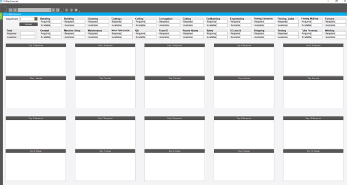

I created a very in depth customization that ran quite a few queries and filled in some grids, boxes, etc. on a form I created. Somehow, the entire UI I created disappeared. Kept all my code, but everything on the display was gone. Frustrating, but things happen.
I recreated the entire thing from scratch. Opened it this morning, and it was fine. Closed it and came back later and everything is “gone” again, but not really…

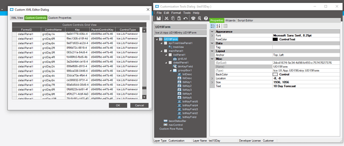

The controls still show under custom controls and custom properties, but do not show up in the tree view of controls.
The form is blank:

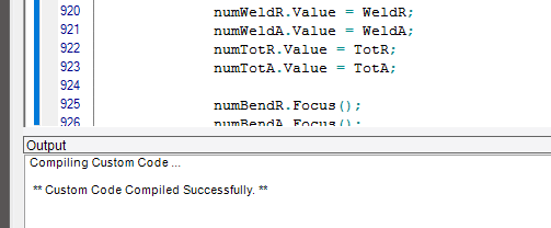

The code, which refers to all these “missing” controls compiles fine:

This does come up when I try to verify the customization in customization maintenance but doesn’t help me much. Maybe someone else has familiarity with it.

Code compiles with no errors, but just to check I commented out all code:

Customization shows no errors other than the one in the snip above, which is the Exception Object reference not set to an object.

It pulls the schedule in by day, checks the calendar for the department to figure out how many hours are working hours for that department (to figure out how many hours are actually scheduled), then the second query determines by employee calendar and department, how many hours are available. The idea is to give us a 10 day comparison of what the machines are scheduled and the labor we have available so we can see whether we have the employees needed to keep up with the machine demand.

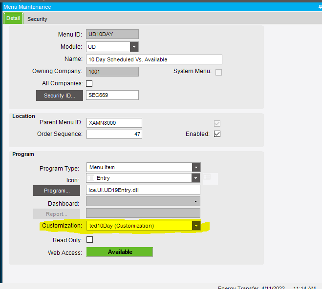

To apply it to a menu item is through menu maintenance:
To create it, must open in developer mode. Bottom of main menu page, turn on the wrench:
It will ask you when you open the menu item, which customization you would like to use (if there are some) or choose base to create one off the base form. It then opens the form normally. Under Action is listed customization or you can right click and choose customization. From there, it’s very similar to how it works on a dashboard.
