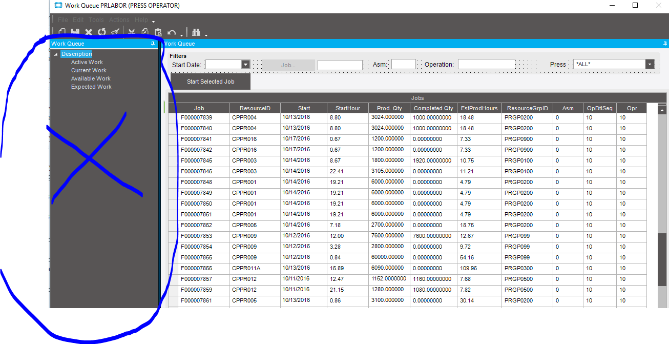

Is there a way to change a controls parent? I tried to grab in the control tree and drag but no dice :tada:
Or how to get rid of a nagging auto-hide dock panel?
Visible = false; nope
Width/Height = 0; nope
Screen shot… what do you need to remove?
Just undock it (Push Pin)
Tools -> Save Layout then open Customization mode, make a small change and save it.
I swear I’ve tried that several times, but maybe since you said it will work this time. (You have the magic touch)
Here is the tree view btw
No Exit customization mode,
Open the Form
UnDock It (Push Pin)
Then go to Tools or Actoins -> Save Layout
Then go to Tool -> Customization
Make a Change
Save it
Ahhhh I forgot the Save Layout step :blush:
Thanks! :gift: :tada: :confetti_ball:

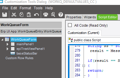

You don’t need to use CSM to get a refernece to the form you already havea reference to the form
See your image 2 posts Up… On the left tree WorkQueueForm (that is your reference) just do WorkQueueForm.WhatEverYouWant();
Oh. I thought that the system controls could not be accessed like that. For example, I cant just use Button1.Click(). That only applies to children of the form then?

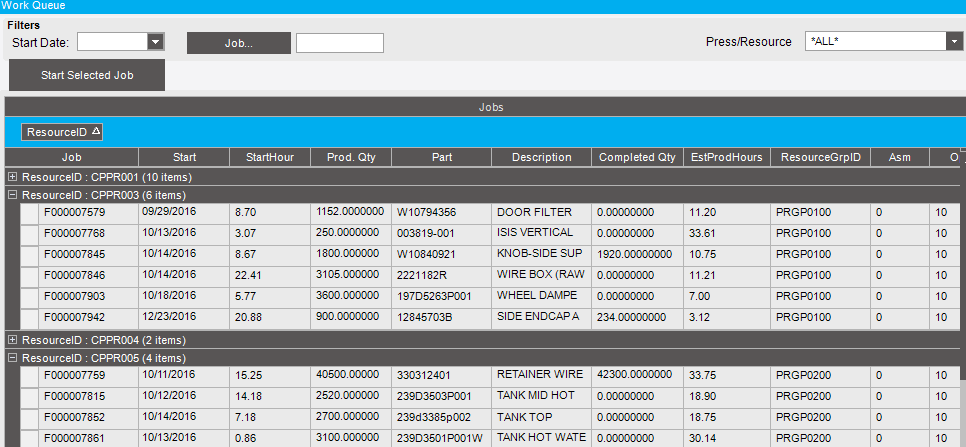

Here is my modified WorkQueue screen. By default I list all open jobs (this can easily be changed to filter by default). The user general will only use the dropdown on the top right to filter jobs on his machine but if needed, they can filter by job number (accepts partials) or dates.
User selects a job and pressed start button then gets a confirmation to start job. At which time, the screen closes.
Additionally, the UltraGrid does some really amazing grouping easily like this where jobs are grouped by machine:

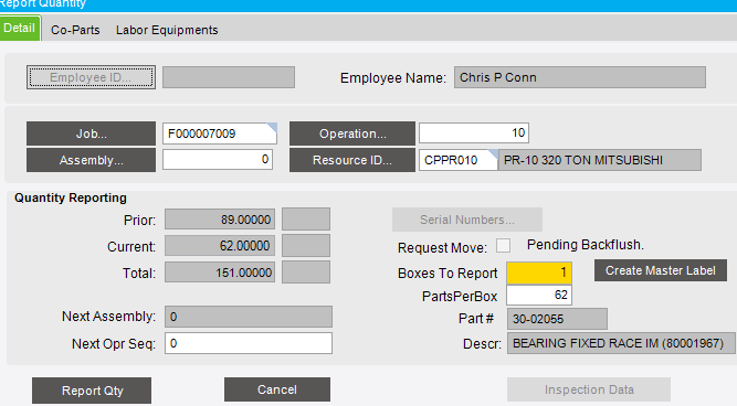

For my Reporting Qty screen I’ve made changes that allow for the user to only report the number of boxes (the Part entry allows us to enter how many pieces per box are std). Then it does the math and calculates the item qty to report.
Once reported, there is a BPM which auto prints the labels to the proper printer based on workstation, it prints a label type (style) defined in Part entry, and also prints how ever many labels per box was assigned in the Part Entry screen.
Also I added a way to see what PN you are reporting as well as button to print a master/skid label.
