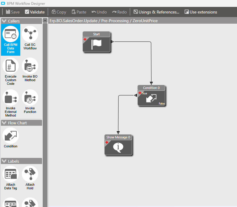

Hello, I want to add a prompt so if they add a line to orderdtl with a 0 price on the part master it shows a message saying this Product is at Zero Value.
I would expect that to be relatively easily tacked with a Data Directive BPM on the OrderDtl with a conditional statement with something along the lines of the ttOrderDlt.UnitPrice field of the added or changed row is equal to the 0 expression and a message box hanging off the true side after the conditional.
You may also want to identify another ‘Price’ field but it would depend on the process your company follows.
Hello. I have done this in the past with a Data Directive. It can be as simple as the Start block, a Condition block, and a Show Message block designed as an In Transaction directive. Take a look and see if that doesn’t get you on the right track.
Just a Method Directive on PRE Update, preferrably PRE MasterUpdate.

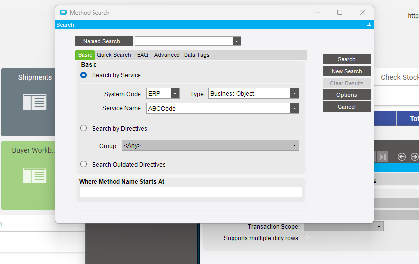

ohh i have this screen
something like this
